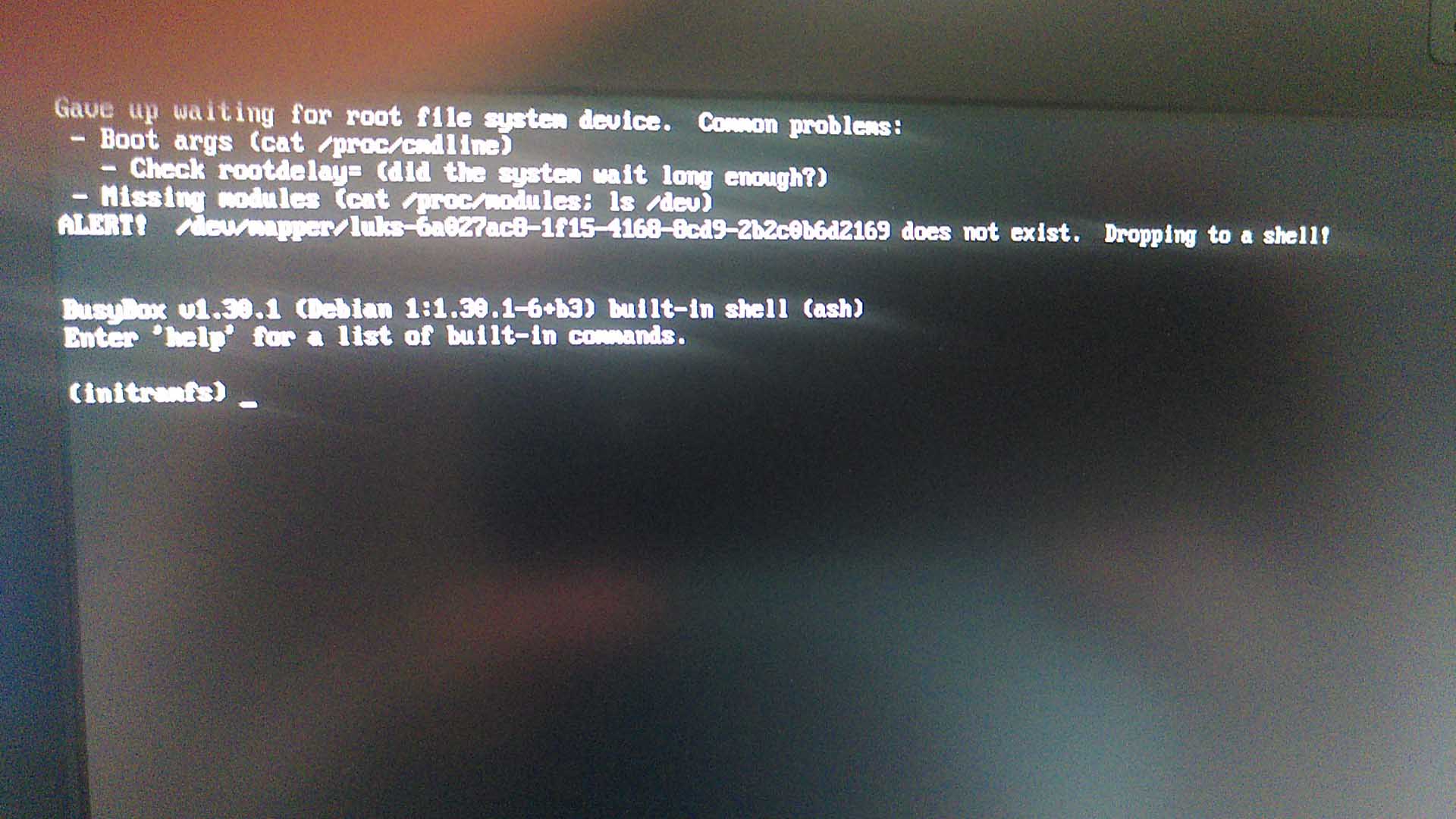

My source (uefi) pc system is encrypted (notebook). USB stick works fine, but installation back on pc with or even without encryption went into a issue. see picture.
i don't know if it's a bug or if my standards are high wink

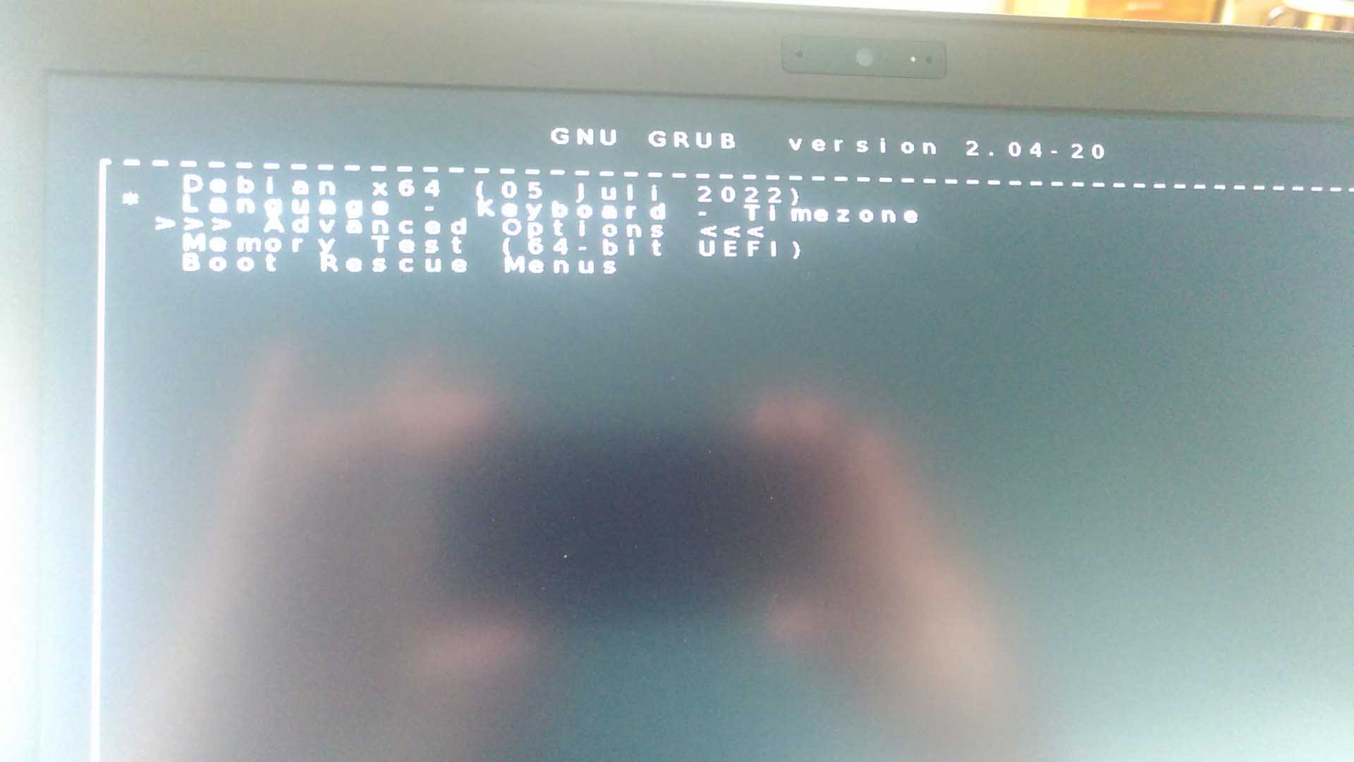

My live USB stick created with MX snapshot/mx live usb maker does now have a error message (pic1), but continues after click.
USB boot menue looks different now, but ok (pic2)

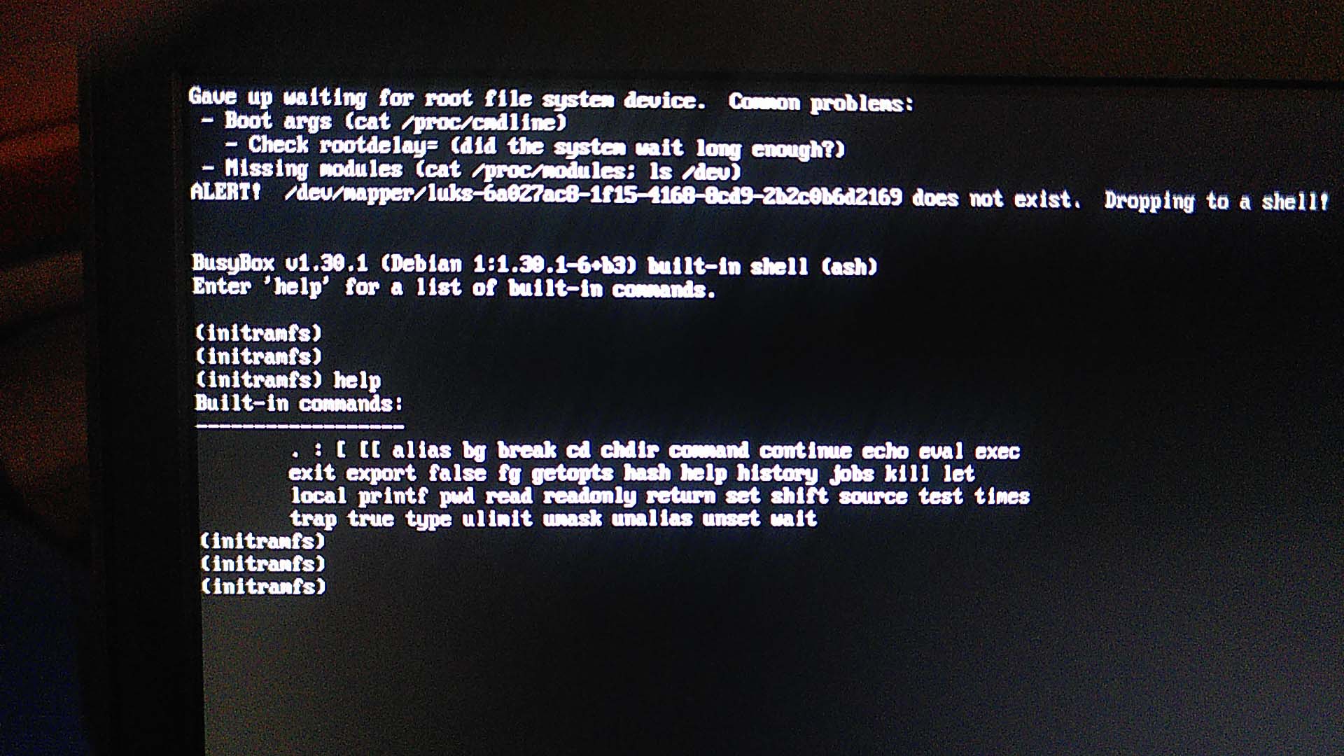

my test from my notebook (plasma4.8, uefi with / and /home partion encrypted), desktop profile ends again with luks error. (pic3)
I'm keeping my fingers crossed that you'll get it right! Thanks.

Pic1.jpg - We can confirm the Grub error message on the live media. It's not critical, anyway, it is going to be fixed.
Pic2.jpg - Ok.
Pic3.jpg - Investigations are underway, we will post here about a possible fix.

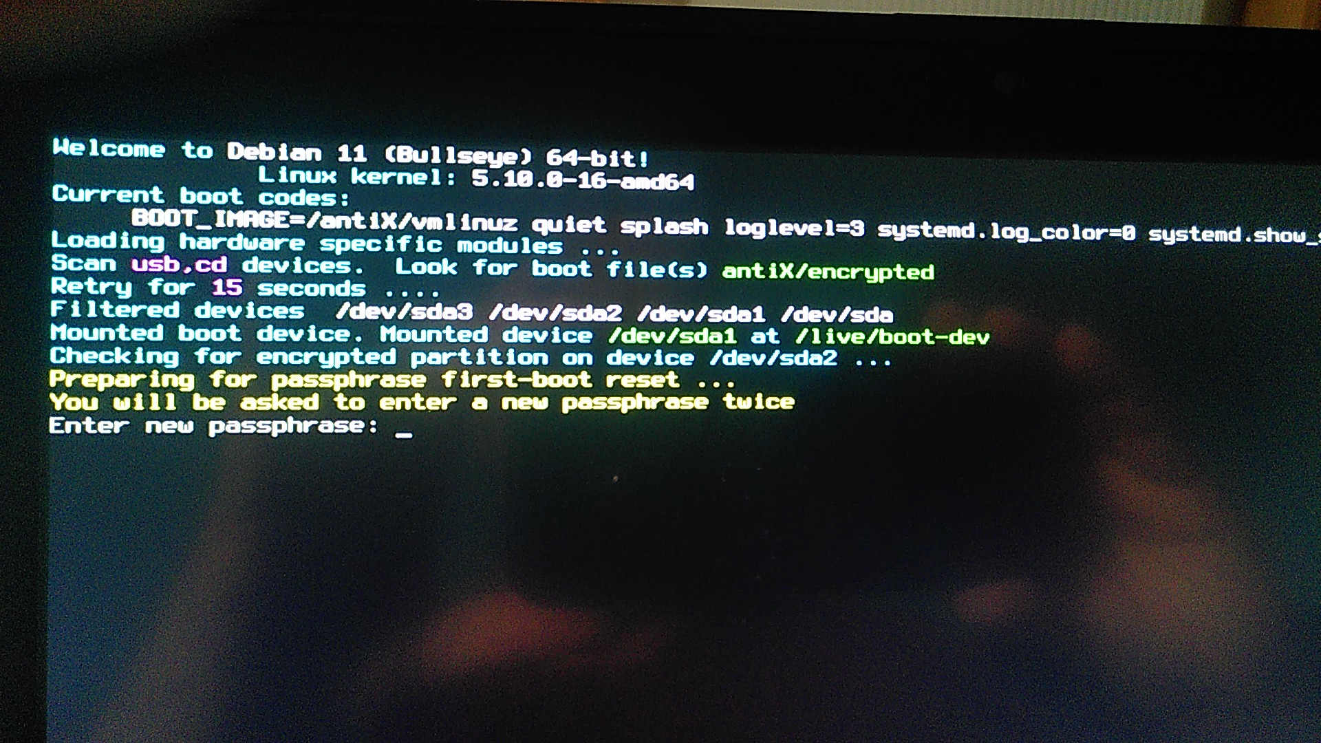

The only thing I've stumbled across so far is when I check the box  'encryption' on the live usb maker. Then the stick starts and hangs when I enter a password. To be honest, it doesn't seem to work with mx linux either. So no idea if u want to look at that. Many thanks so far for your effort!

We have tested the encryption option and it seems to be working fine. The issue may be hardware dependent, or some procedure variation on your side. Please provide more details for us to be able to reproduce and investigate. You also need to enter a new password twice on the first live USB boot, then it only asks for that password on each subsequent boot.
