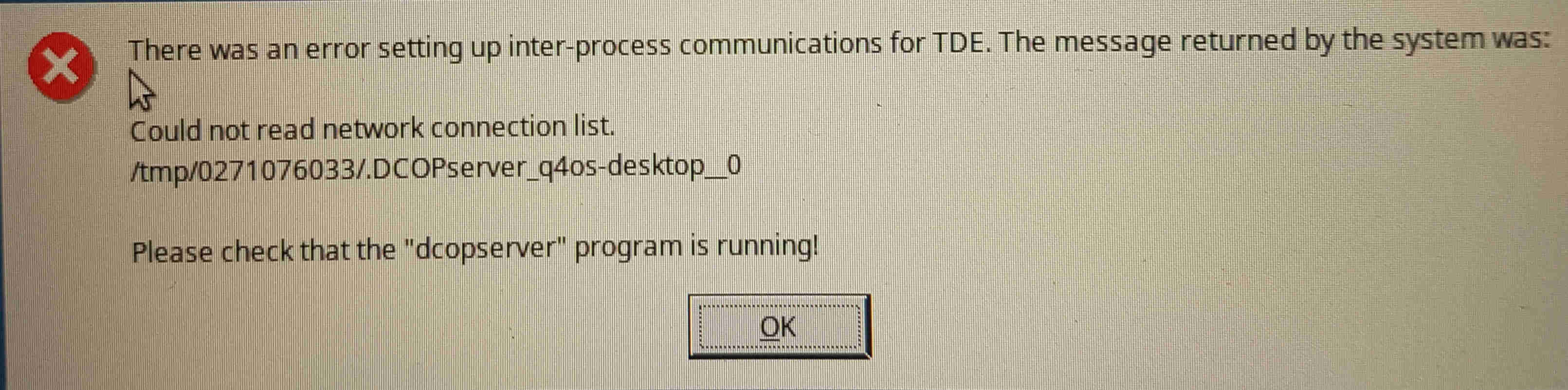

I fetched the 64bit installation disk for Aquarius Trinity from sourceforge, dd it to an usb stick, booted and installed it on yet another USB stick. Sorrily Q4OS fails to run from that one. The laptop boots very slow (several minutes until the blank blue desktop appears), even booting into maintenance mode is very slow and it is not very usefull, since the network is unconfigured and I had not yet set a root password (which I did in the meantime). I do not remember if I was not patient enough during the first boot and interrupted it or if it ended in frozen black screen, which I forced into reboot. During the second boot the appended error message appeared on the empty blue trinity desktop after a very long time, which complains that DCOPserver was not running. I switched to a console and found a running dcopserver.
Any help is appreciated.
In the meantime I succeeded entering maintainence mode and I append the output of journalctl -xb.
Edit: After some googling, I created the readable journal of all 5 attempted boots and extracted the logs of the first and second boot as journal-1st-boot.txt and journal-2nd-boot.txt
journal.txt
as suggested here, I additionally append the output of reportq4 & inxi -Fxxx

The TDE dcop error generally shows up on systems with an extremely slow boot process due to some internal timeouts. We would guess that the USB flash drive is not using the full speed of the USB3 protocol due to an outdated driver. You can try to install Debian Bookworm on this USB stick and compare it with Q4OS Aquarius to see if the problem comes from Q4OS or Debian base.

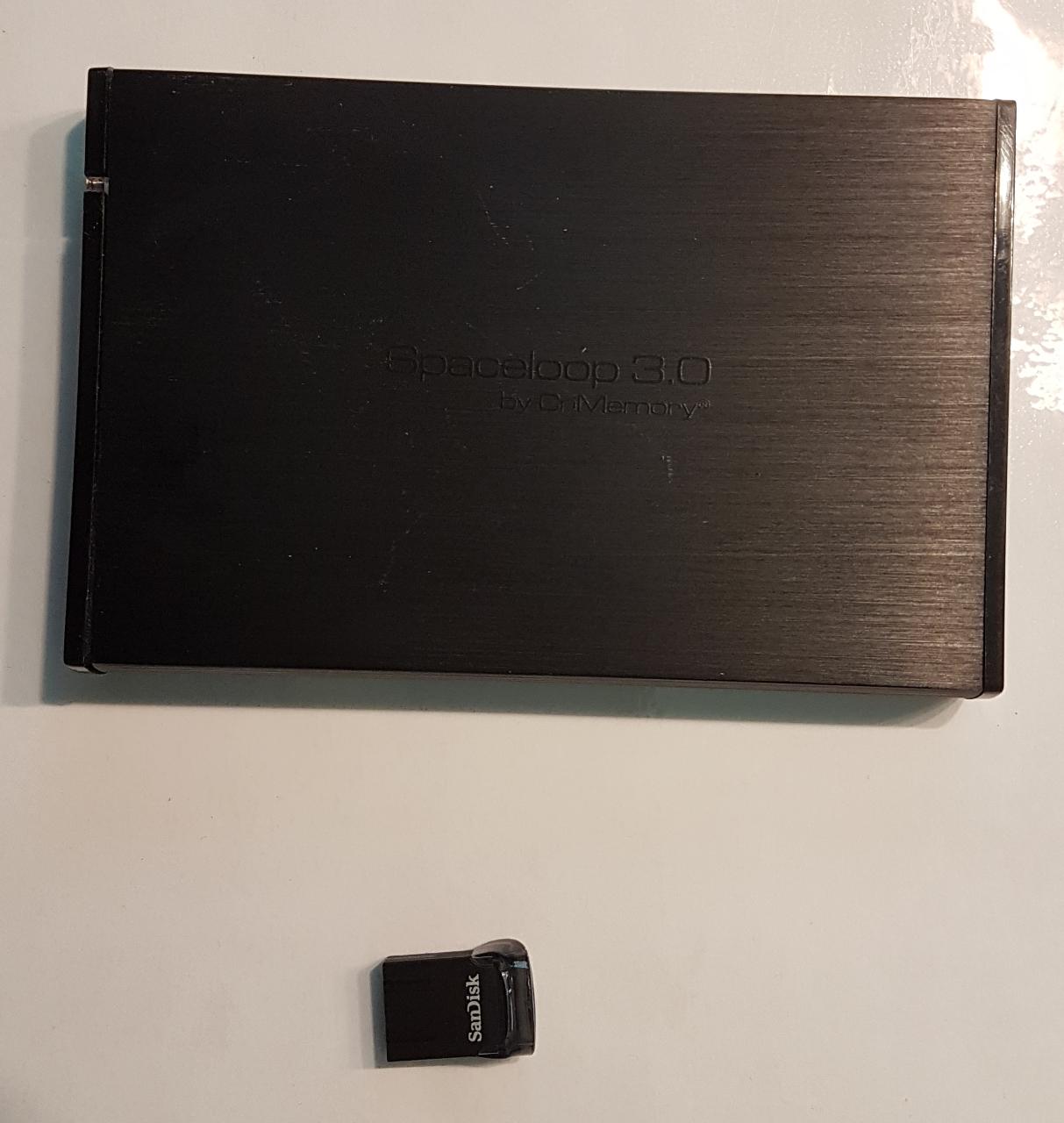

@bernhard
I do know, that Q4OS installation is not your primary OS on your laptop, and you have EndlessOS installed on your internal SSD.
I do not want you to install Q4OS on your internal SSD.
I am trying to convince you to install Q4OS on External USB SSD Disk instead of cheap and slow USB Flash drive.
External USB SSD Disk can be used just like USB Flash drive. Yes, it is bigger sized, but it is also much faster and much more reliable.
That is the fastest and easiest way to solve your problem and have second OS available.
hmm, yes about 100 times larger (length & width is approx. 6 times larger and the height is about 3 times the size), see appended photo.
The SSD Disk I have suggested is not much bigger, than regular USB Flash drives, but it is much, much faster.
