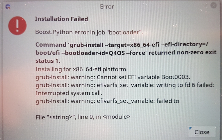

I tried to install Q4OS on USB from the latest Trinity life CD which I found on the Delug DVD published with the german Linux Magazin. I installed Q4OS to a 128GB GPT partitioned USB stick. I had created this USB stick quite some time ago for use with Siduction and made bootable with Refind. I have used successfully for some time, see https://forum.siduction.org/index.php?t … 9#msg57409 but got a bit frustrated by the huge number of updates, which were additionally sometimes problematic, but I wanted to preserve the /home partition for Q4OS, so I did not repartition it. The Q4OS installer went fine until the (final ?) step, where the installation tries to install/update grub (see attached screenshot), it failes in grub_install. Current state is: the stick does not boot Q4OS. I can start Grub 2 from the refind menu, but my knowledge of using Grub 2 comand line is insufficient to find/boot into Q4OS. With Grub legacy I might have been able to proceed, but Grub 2 command line is too different ...

root@localhost:/# grub-install
but I got similar error messages as the Python installer:
Installing for x86_64-efi platform.
grub-install: warning: Cannot set EFI variable Boot0002.
grub-install: warning: vars_set_variable: write() failed: Interrupted system call.
grub-install: warning: _efi_set_variable_mode: ops->set_variable() failed: No such file or directory.
grub-install: error: failed to register the EFI boot entry: No such file or directory.
any ideas?
