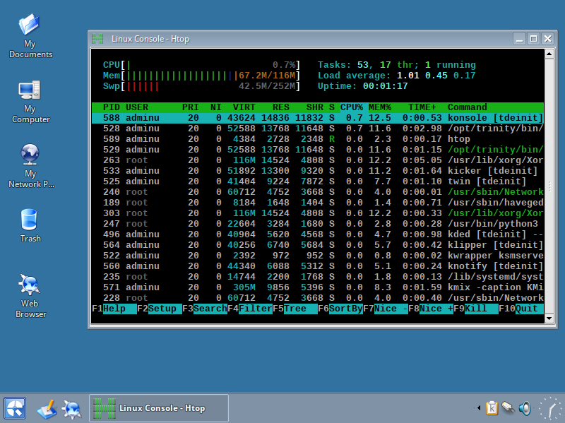

#13 2021-06-25 18:24
aluma
From: Ukraine
Registered: 2018-03-12
Posts: 136
Re: 32 bit install goes to console mode not Trinity
But you're right, looking at pictures and reading the text is quite convenient and works smartly.
In the days of dialup, I often used Links, mainly in graphical mode, and then and now it does not display sites quite correctly.
PS. Just to make life easier for a computer in ancient times, I ran Links under Window Maker. smile
