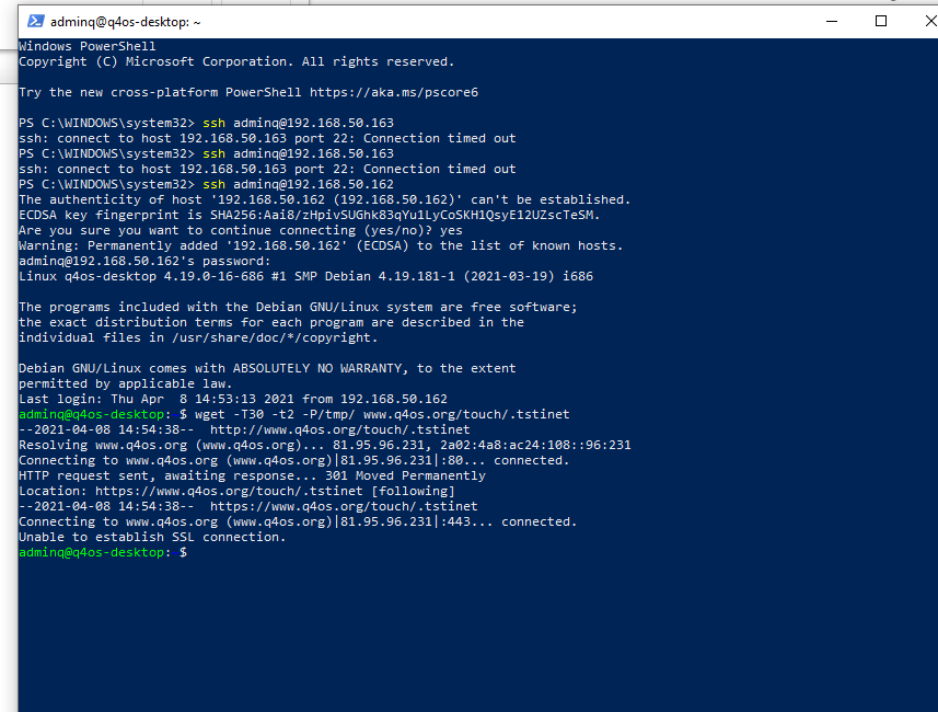

We are not able to reproduce the issue. Please run in terminal:
$ wget -T30 -t2 -P/tmp/ www.q4os.org/touch/.tstinet
and post output of the command here.
#3 2021-04-08 16:04
macg143
Registered: 2021-04-08
Posts: 17
Re: Desktop profiler failed after fresh install on 32bit i386 Via EPIA
Hi Thankyou so much for the quick reply
Here it is
Thanks
#4 2021-04-08 16:36
Posts: 6,488
You can get "Unable to establish SSL connection" from wget if you're behind a proxy and don't have HTTP_PROXY and HTTPS_PROXY environment variables set correctly. Make sure to set HTTP_PROXY and HTTPS_PROXY to point to your proxy.

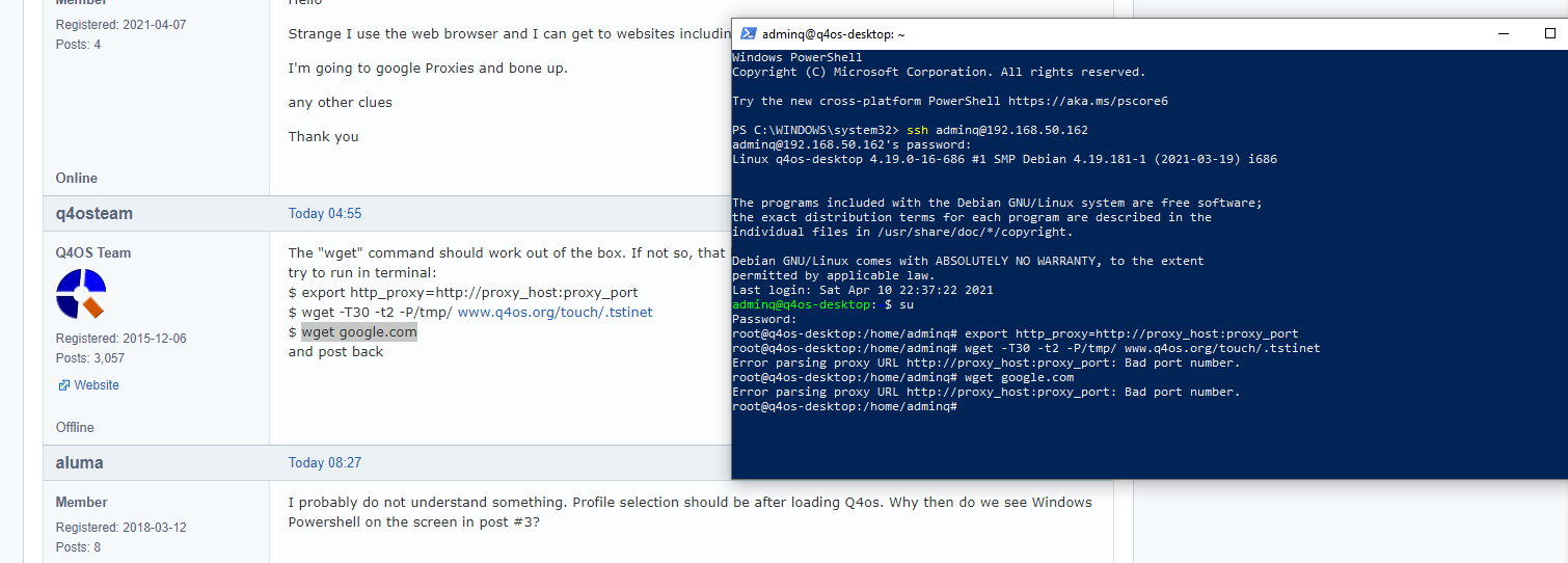

#7 2021-04-10 09:55
Posts: 6,488
The "wget" command should work out of the box. If not so, that looks like your network utilize a proxy server. Please try to run in terminal:
$ export http_proxy=http://proxy_host:proxy_port
$ wget google.com
and post back
#8 2021-04-10 13:27
aluma
From: Ukraine
Registered: 2018-03-12
Posts: 136
I probably do not understand something. Profile selection should be after loading Q4os. Why then do we see Windows Powershell on the screen in post #3?
#9 2021-04-10 23:58
macg143
Posts: 17
Hi q4osteam
Here it is.
I am logging in remotely from my W10 PC using the power shell so I can do a  screen capture with snipit tool
Is that ok ?
#10 2021-04-11 00:01
macg143
Posts: 17
Hi Aluma
If I do it directly at the computer then I would have to take a pic then copy it to my windows pc
Doing it remotely helps out with screen capture
regards

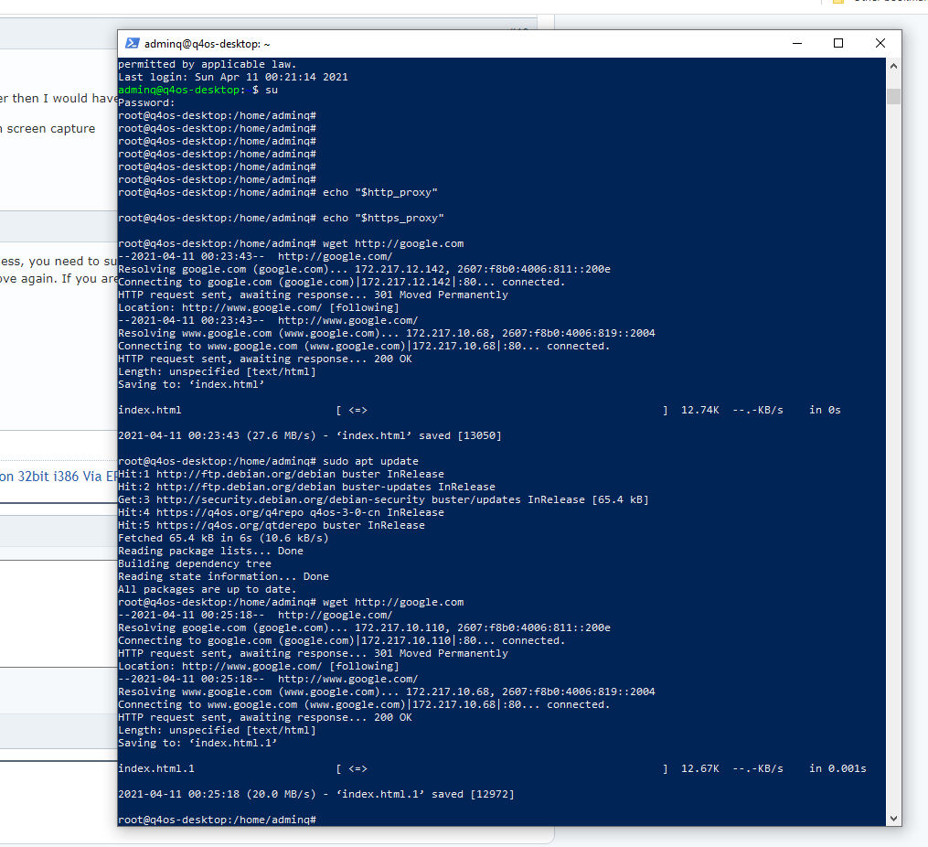

#11 2021-04-11 01:02
Posts: 6,488
Yes, SSH access is ok. Nonetheless, you need to substitute "http://proxy_host:proxy_port" with your real proxy settings and run commands above again. If you are not behind a proxy, just run:
$ wget google.com
and post back.
#12 2021-04-11 01:29
macg143
Posts: 17
Hi q4osteam
How do I find out my real proxy settings?
But I've included a pic to see if it gives you any valuable info.
thanks
#13 2021-04-11 01:40
macg143
Posts: 17
Hi
When I use the web browser I can get to q4os web site (https://www.q40s.org/)
and also google (http://www.google.com/)
I'm not sure if this gives you any valuable info in regards to https & http ?
I just don't know how to find out my proxy settings
echo 'https_proxy' & echo 'http_proxy' return nothing, not sure what that means
Thank you

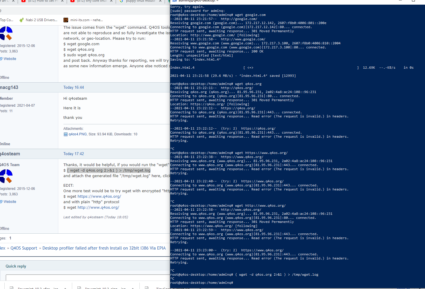

#17 2021-04-11 17:17
Posts: 6,488
@macg143

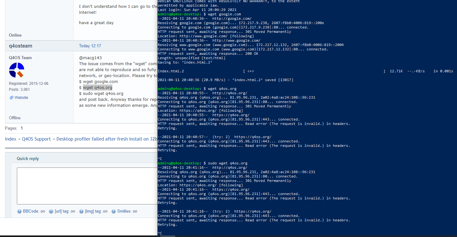

The issue comes from the "wget" command. Q4OS tools use "wget" to check for the Internet access. Unfortunately, we are not able to reproduce and so fully investigate the issue. That looks like it's somehow specific to your hardware, network, or geo-location. Please try to run:
$ wget google.com
$ wget q4os.org
$ sudo wget q4os.org
and post back. Anyway thanks for reporting, we will try to reproduce and investigate the issue and post back as soon as some new information emerge. Anyone else noticed similar issue ?
#18 2021-04-11 21:44
macg143
Posts: 17
Hi q4osteam
Here it is
thank you

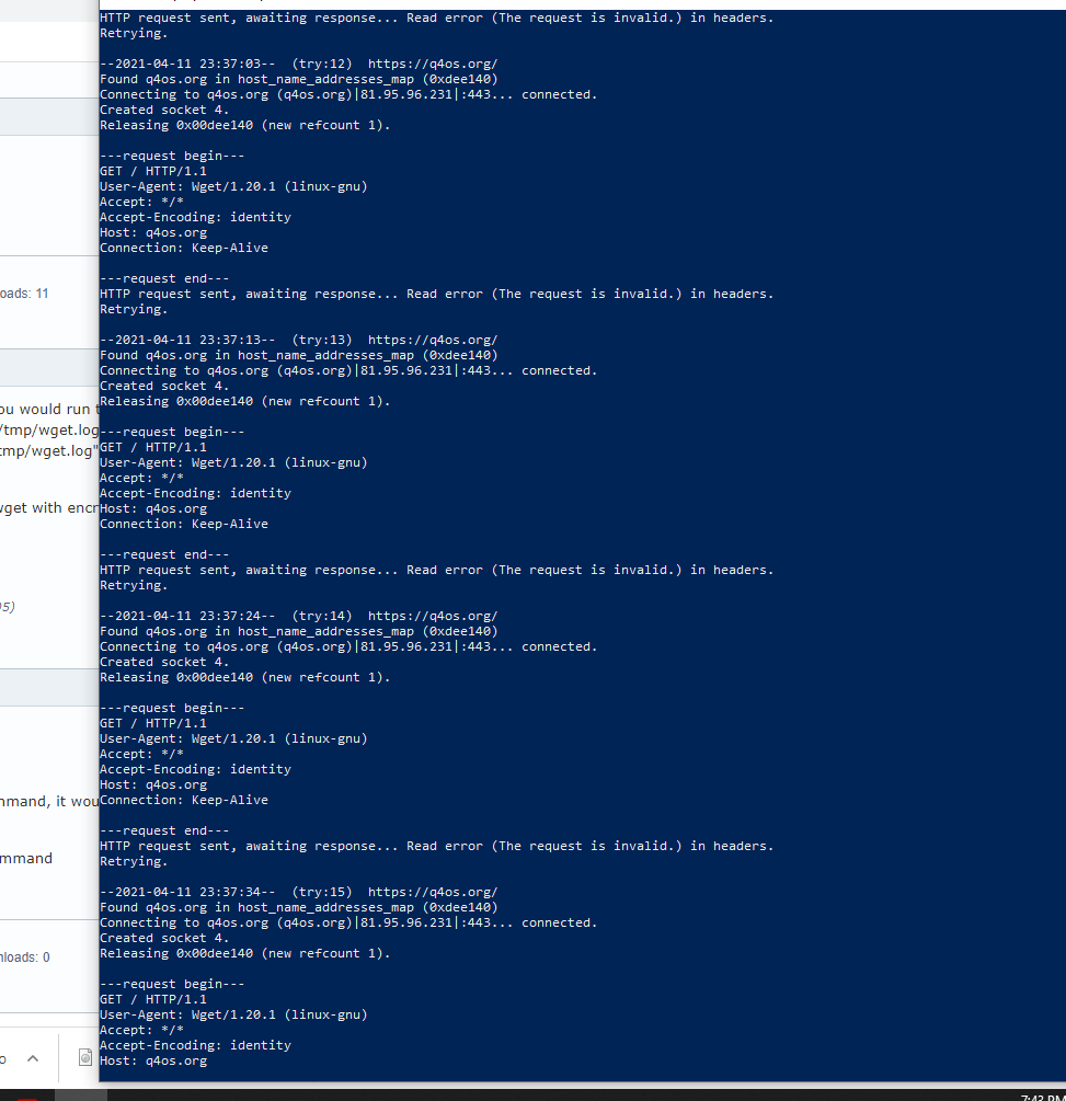

#19 2021-04-11 22:42
Posts: 6,488
Thanks, it would be helpful, if you would run the "wget" command once again with debug information output enabled:
$ ( wget -d q4os.org 2>&1 ) > /tmp/wget.log
and attach the generated file "/tmp/wget.log" here, click Post reply > Choose file button
EDIT:
One more test would be to try wget with encrypted "https" protocol:
$ wget https://www.q4os.org/
and with plain "http" protocol
$ wget http://www.q4os.org/
#20 2021-04-12 00:31
macg143
Posts: 17
Hi q4os team
Here's a pic
Not sure of the wget.log file command, it would never return to the prompt, I had to control C it to get the prompt back.
Not sure of the syntax of the command
thank you
#21 2021-04-12 00:45
macg143
Posts: 17
Hi q4osteam
Here's a pic of a cat of the wget.log file, don't know how to get it on my pc
thanks you
#22 2021-04-12 00:55
macg143
Posts: 17
Hi q4osteam
I was able to get it on a usb in linux and then move it to the pc smile
thank you
wget.log
