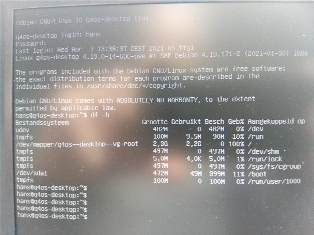

#7 2021-04-07 13:24
CyclePiet
From: Nederland
Registered: 2021-04-03
Posts: 6
Re: Error code 80
I don't know how to post a photo here?
                                                                                          size  used available used% mounted at
I saw for instance one line: /dev/mapper/q4os--desktop--vg-root 2,3G  2,2G           0  100%  /
Asus EeePC 901 Netbook, 1GB mem, 4GB + 8GB SSD.

#9 2021-04-07 17:48
CyclePiet
From: Nederland
Posts: 6
Re: Error code 80
I think i clicked first on the wrong reply.
jpg IMG_20210407_135045277_BURST000_COVER(1).jpg, Size: 130.65 KiB, Downloads: 769
#10 2021-04-07 22:24
Posts: 6,251
Re: Error code 80
The root filesystem 2,3GB is too small for the profile you attempt to apply. We would recommend you to make at least 3GB space for the root partition.
