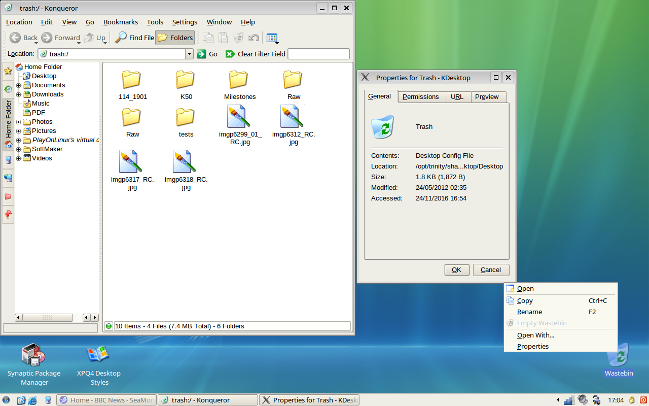

I know I have raised this issue before but it seems to be back.
I have lots of items in Trash, but right click on Recycle Bin shows Empty Trash is greyed out.
Attached screen shot shows the current state. Trash is owned by root.
Puzzled!

... but right click on Recycle Bin shows Empty Trash is greyed out.
It is very probably connected to this issue http://www.q4os.org/forum/viewtopic.php?id=1193 , already reported here https://bugs.trinitydesktop.org/show_bug.cgi?id=2729
Does the trash recover, if you logoff/login ?
That is correct.
I wasn't sure if it was related - it's no big deal but just puzzling as I know that it is a random problem.
Booted up this morning - still the same problem.
Thanks anyway - will wait and see if resolved.
Update:-
So I emptied the trash folder by hand, then dropped a few files in and it worked as expected.
Previously there was a lot of stuff in there - probably 150mb of RAW files that I had dumped in there earlier.
I'll have a fiddle and see if I can reproduce the issue.

OK - I have been able to reproduce the issue, but it may be a bit of an edge case.
I use a photo viewer/editor windows program called Faststone - it works fine under a basic Wine install - handles RAW files quite happily with no problems.
If I delete files from with the application it reports that the files will be moved to the Recycle Bin - and off they go.
In that case the Desktop Wastebin does not show a file icon nor does it allow Right Click>Empty. The files are in trash:/ Essentially it is exactly as originally reported.
However if I delete via Konqueror then behaviour is as expected.
So - although the files do get to trash:/ their presence does not trigger something that would update the Wastebin.

We are now able to reproduce this issue, it affects wine applications in general. We are going to investigate it more, and will keep posting here. The most easy steps to reproduce:
- install 'wine'
- run from terminal
$ wine notepad
- click Menu -> File -> Open...
- navigate to some testing file
- right mouse click -> Delete -> confirm moving to trash
- trash is showing empty, even the deleted item is in
