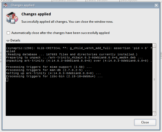

#3 2016-09-07 19:57
Posts: 6,482
Re: libc-bin hangs in ark-trinity
@olzeke51
We guess the ark-trinity installation in Synaptic passed well, as the message 'Processing triggers for libc-bin (2.19-18+deb8u4) ...' is the last message of the ark-trinity installation process. If you had 'Details' window opened in Synaptic, this installation message could be a bit confusing for you, nonetheless you can safely close the dialog and finish Synaptic.
Please, see the attached screenshot and confirm our assumption.

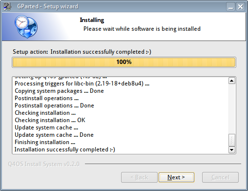

#7 2016-09-07 22:28
Posts: 6,482
olzeke51 wrote:
3.   Ctrl-C  releases me from the 'hangy status' - perhaps 'abort' would be a better term
Ok, thanks. Synaptic never reports 'Finishing installation ... Installation successfully completed :-)' messages. The message 'Processing triggers for libc-bin (2.19-18+deb8u4) ...' is correctly emited as the last message of the install process. If you are able just press 'Close' button instead of Ctrl+C in Synaptic 'Changes applied' dialog, the install process finishes well without any error.
The good - your APT system is ok, as the command 'sudo apt-get check' passed well.
'AS you can see ..I get the installation message  [Synaptic 0.81.2]  [grz *****]***************
after I have the details - I will then click on <close>
when I had the libc-bin 'hangs'   - by nature/habit I did a Ctrl-C (other key inputs had no effect)

Unfortunately we are not able anyhow reproduce the Synaptic (libc-bin) hang or error. All the messages you have posted here are correct and show no error.
The message is correct, and properly the last message, no hung, as you can see here http://www.q4os.org/forum/attachment.php?item=115.
olzeke51 wrote:
...hung at the libc-bin processing  -- so I did a Control-C to get out of it
Please try just to press 'Close' button instead of Ctrl+C the next time.

THANKS for the tip on screen capture !!! I thought there had to be an easy way.
My apologies - some of my software was loaded through the S/W Center - install app -- here is a screen shot of gparted - it has the "finished statements"
** attached file.
Some of my other installs ie. the    xxxx-trinity programs had to go through Synaptic.
The journey is . . . the reward.
#11 2016-09-08 15:03
That capture is from a software centre install, they will have a finished button like the one shown, synaptic just has a close button when finished or if you do like I do and put a check mark where it says Automatically close after the changes have been successfully applied (see attached file) it will just close the dialog when installation has finished, this could help to prevent any confusion as to whether something has been successfully installed or not. smile
And just as a note, if you name your files screen-shots with a png extension they can be viewed easier in the forum smile
