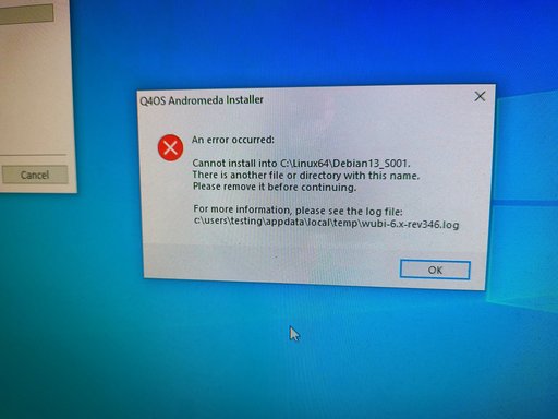

I’ve tested the Windows installer on a licensed Windows 10 Home PC (Dell Inspiron 20 Model 3034 Desktop) I did a fresh clean install of the OS from unallocated space, not signed into a Microsoft account and OneDrive completely disabled I was getting the error code “Cannot install into C:/Linux64/Debian13_S001. There is another file or directory with this name please remove it before continuing” Because the OS is 100% fresh the issue is likely coming from the installer itself.
This message is unknown to us, would you attach a screenshot please ?

Lilith wrote:
Cannot install into C:/Linux64/Debian13_S001. There is another file or directory with this name please remove it before continuing ... Because the OS is 100% fresh the issue is likely coming from the installer itself.
Now we can see the screenshot attached. Yes the message is coming from the Q4OS installer. However we can't reproduce it in anyway. Does the "testing" user have admin permissions ?
Would it be possible to delete the "C:/Linux64/Debian13_S001" folder, reboot PC, run the q4os-winsetup.exe again and post back the result ? The logfile c:\users\<username>\appdata\local\temp\wubi-6.x-rev346.log would be also helpful - if possible, ship it via e-mail.

I wanted to report something very strange at first I tried to using the Q4OS Windows installer on a completely fresh, clean install of Windows 10. The hard drive had over 400GB of free space. Every time I ran the installer and several reboots possibly 5 or 6 times it would throw me the same error. I even tried making a fresh clean secondary admin account to try it on but had the same results. But after I installed Quarkos Resolute alongside Windows 10 I actually shrunk the Windows partition down to 32GB and left the rest for Quarkos I went back in Windows 10 deleted everything you asked including the installer emptied the recycling bin re downloaded the installer again and tried it out now it works! I now am running Q4OS with Windows successfully. It seems like the installer really dislikes large, fresh Windows partitions like 400GB+ but shrinking the partition down completely fixes the issue and lets it run.
