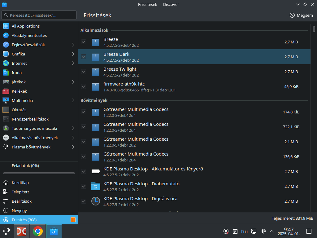

#8 2025-04-01 09:20
willmenn
Registered: 2025-02-26
Posts: 7
Re: System update
I'll try it.
#9 2025-04-01 09:22
willmenn
Posts: 7
Re: System update
It's been like this for over half an hour!
#10 2025-04-01 09:28
Posts: 5,125
Re: System update
Well, now we understand better. Please close the window of Discover application and run commands in terminal:
$ qrepolist
$ sudo apt update
and post the output here

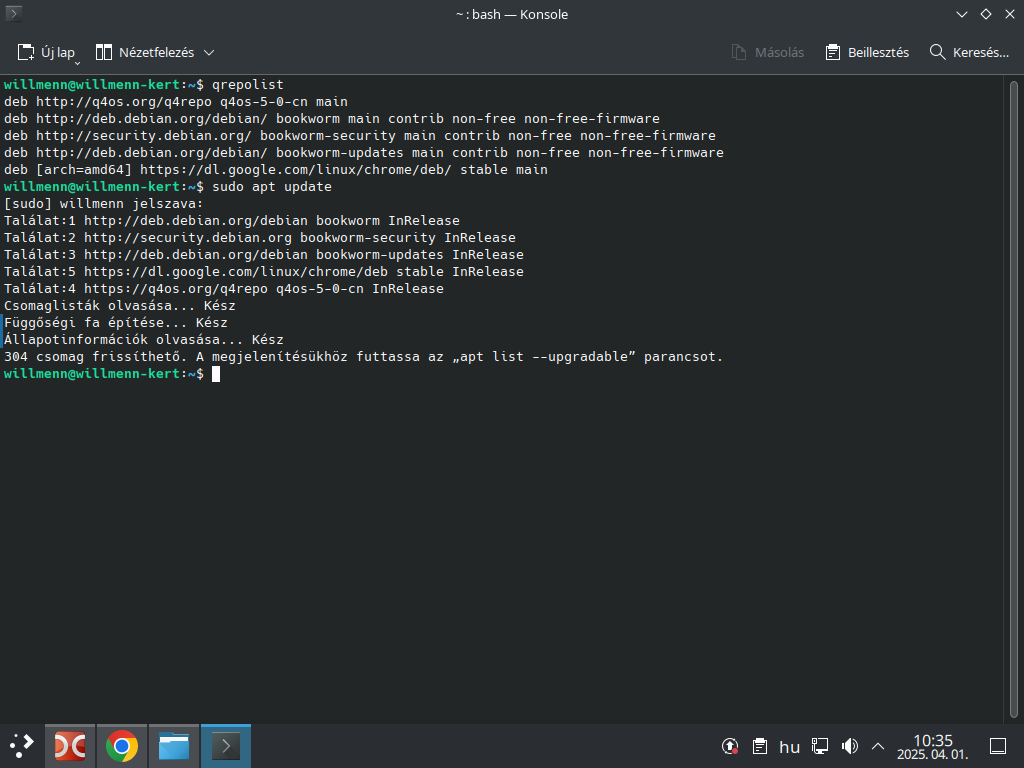

#11 2025-04-01 09:36
willmenn
Posts: 7
Re: System update
Thank you, I will send the result.
#12 2025-04-01 09:40
Posts: 5,125
Re: System update
Now run in terminal:
$ sudo apt full-upgrade
That should proceed all updates. If it ends up with an error please post it here.
