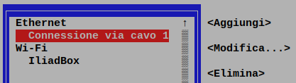

Network with nmtui – commands executed with connection “off”
If I select “Activate a connection”, I’ve got only the Ethernet connection and no wireless network visible
if I select “Edit a connection”, I’m able to see the one created in Network Manager
(see pic 04)
I’ll wait for your input to see if I need to dig more into this

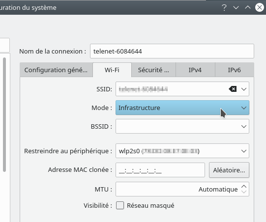

In the output of $ sudo iwconfig, I read
wifi0     IEEE 802.11b  ESSID:"iliadbox-******"
          Mode:Ad-Hoc ...
although on my wifi, Mode is "Managed", not "Ad-Hoc"
In your screenshot, there is no bar-graph showing the WiFi signal level...?

I had the chance to do the  two steps
Wi-Fi Configuration
I have only 3 possibilities to choose from:
Client
Hotspot
Ad-Hoc
Client is simply not working and no message is issued
Hotspot is not working and the following message is issued:
Connection “Iliadbox” is not available on device enp2s2 because profile is not compatible with device (the device does not support Access Point mode)
The only connection working is when I use the “Ad-Hoc” mode
Regarding rfkill, I’ve installed it using Synaptic; I’ve got version 2.38.1-5+b1 (latest).
When I tried to run the command “sudo rfkill” in terminal (Konsole) I have no output whatsoever. If I simply run “rfkill” I got the following message
“bash: rfkill: command not found”
Thanks again
#12 2023-11-03 15:00
Posts: 626
Re: [SOLVED] WiFi is connected but can't access Internet
rfkill is available only for the "superuser", so it is normal that, without sudo, you get "command not found".
What is strange is that sudo rfkill lists nothing, just as if no WiFi adapter is found on your system. No idea what the problem can be.
Except maybe a bad configuration as a consequence of several tries. Maybe you could boot from a live CD, watching carefully if you see a warning about WiFi, and check if your WiFi works. If it doesn't work either, maybe a driver or hardware problem, but I fear I can't help further.
