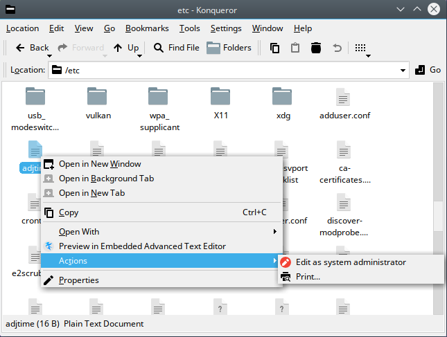

2) in Konqueror there once was a possibility to edit files as root.
There was an entry in the upcoming popup Menu by a right-click on a file: -> Actions with two sub-entries:
- Edit as root  and - print.
They are all gone - is there a possibility to get these handy entries back in konqueror?

With regard of 2), well this is funny: for all (text) files which i'm able to edit by simply double-clicking on, konqeror offers the option Actions -> "Edit as Sysadmin" in the right-click Menu. Hmmmm.

Ad2) We are not able to reproduce the issue, the options are still here, see
What way did you install Q4OS exactly ?
http://www.q4os.org/forum/qimg/qg0052.png
Many thanks for your assistance. You probably will be able to reproduce this soon:
After looking some seconds at your hardcopy of konqueror (in that grayish modern... well, design) i observerd, that you obviously did not use the folder pane to navigate to the folder /etc, right? And that seems to make a great difference for Konqueror:
After entering /etc in the location field directly and right-click on the file adjtime, the entry "Actions" is indeed present in the popup menu!
But if you restart konqueror, activate "Folders" click on the node "10.7GB Fixed Disk (/dev/sda4)" (in my case), expand it, click on etc and then right-klick on "adjtime"... guess what happens:  the entry "Actions" is missing now!
So, "system:/media/sda4/etc" and "/etc" makes some special difference for konqueror. Not particularly nice imo.

... activate "Folders" click on the node "10.7GB Fixed Disk (/dev/sda4)" (in my case), expand it, click on etc and then right-klick on "adjtime"... guess what happens:  the entry "Actions" is missing now!
Yes, we can confirm the issue now. Anyway it's reproducible on a pure Trinity/Debian installation, so it's an upstream Trinity bug, please report it at http://trinitydesktop.org/
