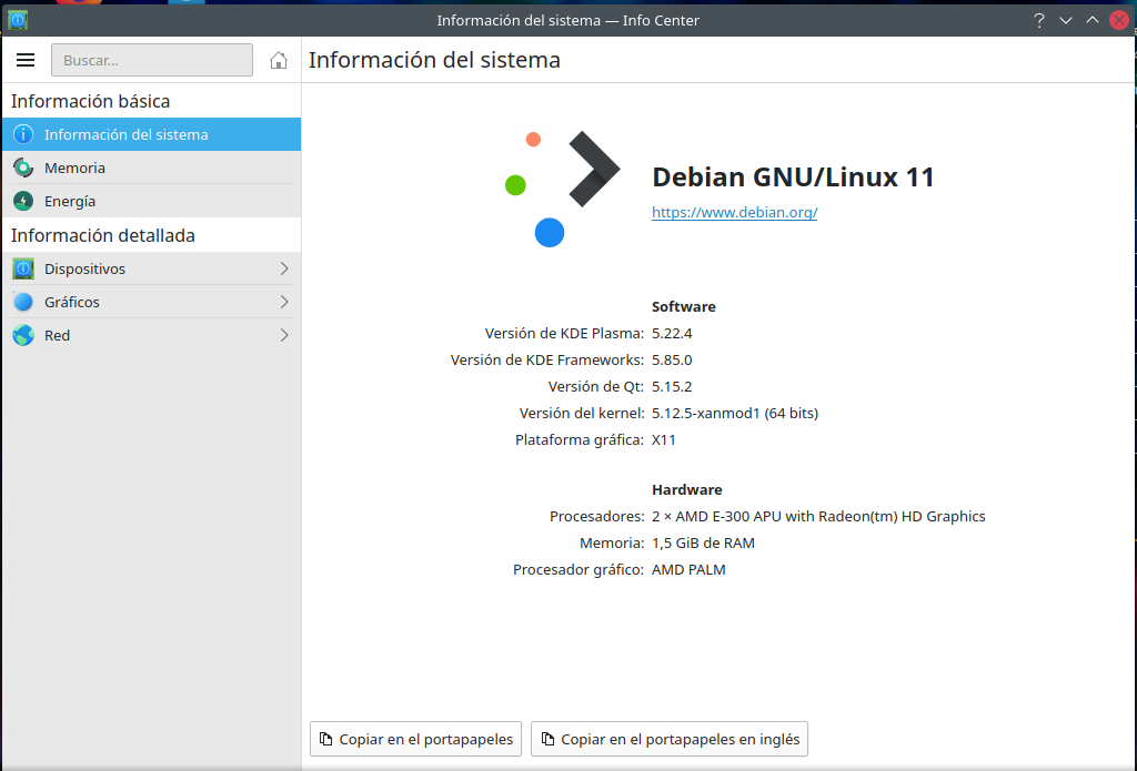

NOT q4os (I only use the Trinity desktop with Q4os), but this is my FrankenDebian (Bullseye + Firefox from SID to keep it updated + Plasma from npreining + M$ Edge because it's actually LESS horrible than the google garbage in Chromium, although Firefox is the default):
Q4OS Trinity machine - Lenovo ThinkPad L14 Gen3 AMD.  AMD Ryzen 7 Pro 5875U, 64GB LPDDR4, 1TB m.2 NVMe SSD, Vega 8 iGP, Qualcomm QCNFA765 Wifi 6E + BT 5.2, 14" 1920x1080 low-power 400-nit LCD.

Re: OBS builds of KDE/Plasma for Debian/Bullseye
https://i.ibb.co/sJHNfp3/ksnip-20210824-192349.png
Nice desktop. I actually tried Q4OS trinity first, and I kind of liked it being lightweight and fast, but:
