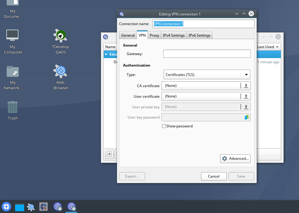

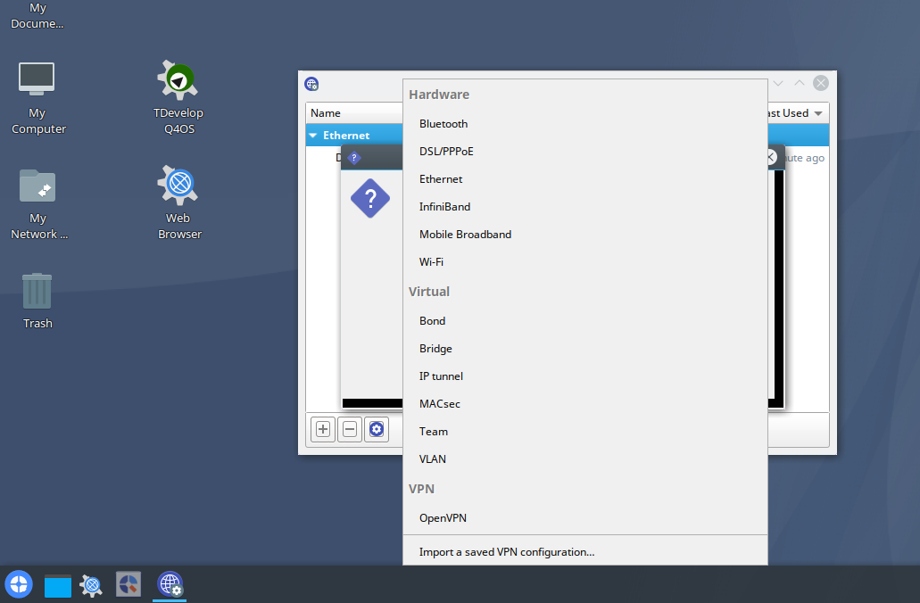

Nonetheless, you can setup VPN connections in Q4OS Trinity the following way:
1. Install "Network manager" from the Q4OS software centre
2. Install packages: "sudo apt install openvpn network-manager-openvpn network-manager-openvpn-gnome"
3. Reboot
4. Setup VPN connections using the network manager system tray icon, see pictures attached bellow
Check!
And success ! I tested this now in VM and it worked.

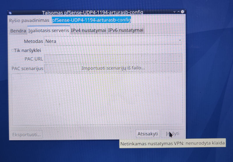

Well, after the success in VM, I still have problem on real HW (MacBookPro 2014).
Did everything as per instruction, but after I pick my OpnVPN config file, I get different window, please see attached picture. Major part of the info from the config file wasn't imported and I move mouse pointer over the Save button it says "Bad VPN settings:unknown error".
Exactly same steps in VM worked just fine - what's wrong on the real HW ? What should I check next ?

OK, managed to resolve the problem myself wink
After openvpn and network-manager-openvpn were installed I couldn't import my config and the OpenVPN window looked strange/incomplete for OpenVPN settings, e.g., there were no fields for certificates and more.
I launched NM Connection Editor in CLI
sudo nm-connection-editor
and got following error after I tried to import my OpenVPN config
** (nm-connection-editor:1863): WARNING **: 10:29:14.083: Nepavyko įkelti „org.reedesktop.NetworkManager.openvpn“ VPN redaktoriaus įskiepio (trūksta įskiepio failo „/usr/lib/x86_64-linux-gnu/NetworkManager/libnm-vpn-plugin-openvpn-editor.so“).
It basically says that the ibnm-vpn-plugin-openvpn-editor.so is missing. It looks that this editor is a part of network-manager-openvpn-gnome package. Installed that one et volia ! Was able to import my OpenVPN config successfully!
The only mystery is why it was enough to install network-manager-openvpn to the VM and it was OK, but on the bare metal it also needed the network-manager-openvpn-gnome to be installed.....
