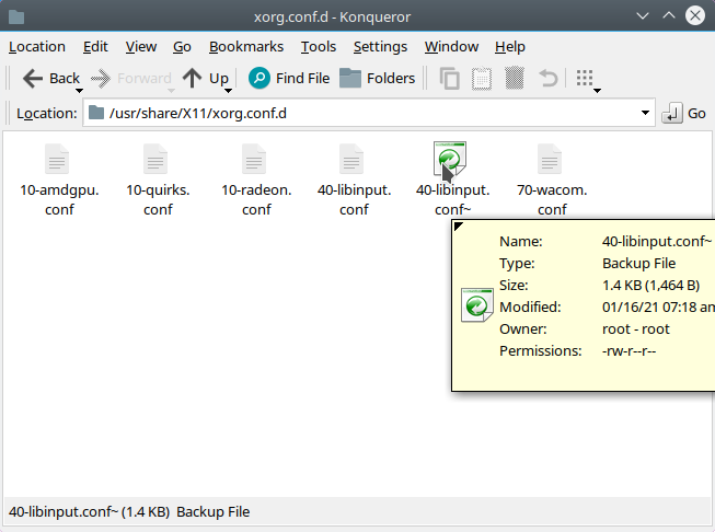

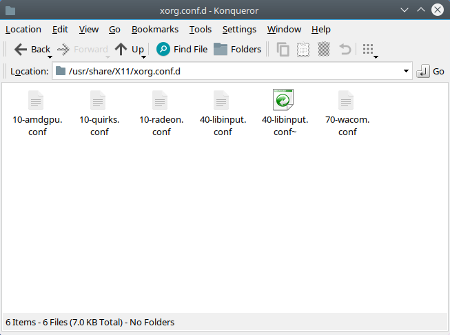

It appeared to create a "backup" of the 40-libinput.conf file when i edited the original.?
Also  /etc/X11/xorg.conf.d/ is empty.,...no files.
The default editor (Kate?) must be setup to do that. You can change the behaviour in the program's configuration if you want. You can delete the backup file or leave it. It won't get read because it's not a ".conf" file anymore.
That makes it easy then!
And did the change work?

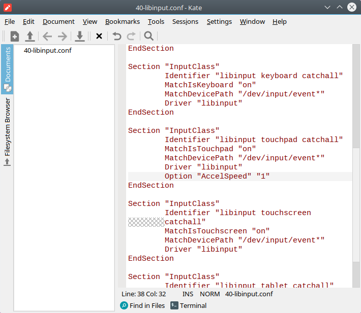

No effect that I can tell, Would it make a difference of using Option "AccelSpeed" "+1"

What have you got in the "pointer catchall" section of /usr/share/X11/xorg.conf.d/40-libinput.conf?
(Option "AccelSpeed" "+1" is the same as Option "AccelSpeed" "1")

{Section "InputClass"
        Identifier "libinput pointer catchall"
        MatchIsPointer "on"
        MatchDevicePath "/dev/input/event*"
        Driver "libinput"
EndSection}
I had {Option "AccelSpeed" "+1"} in there but since it didnt do anything I removed it.
Should I re-install it?
