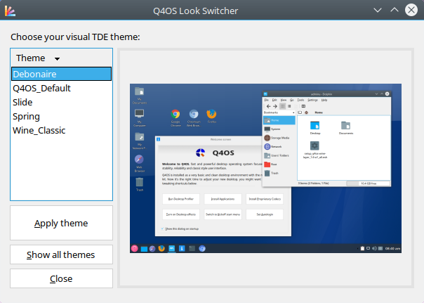

I was using KDE 1.x back in the late 90's I cannot get on with the new fangled things smile
I totally agree with you!!... I do really like the Debonaire though...very clean.
