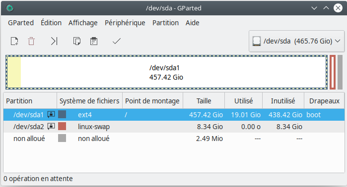

A first thing is to check whether your Windows partition is still present on your hard drive. You can do this using gparted. If you see an NTFS partition, there is a chance your Windows system and data are still there. Otherwise, if you only see ext4 and linux-swap (see my screen capture, I have only Q4OS on my hard drive), then your windows partition has been erased during Q4OS installation and I fear there is no hope to get it back.
