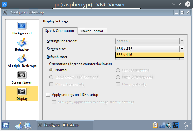

Ok Dia, I followed your tutorial and now have ssh and VNC working. But, I got a problem.
I originally set up my pi 3+ with a keyboard, mouse, and HDMI display. So I already had wireless set up when I started following your instructions. Everything worked fine, except for the display resolution! I only have one selection and cannot change it. I have tried changing the dpi, but can only go down to 60 which still does not help.
Maybe the snapshot I took can help you figure out what I need to do. I'm at a loss at this time.
The pi is working headless now, thanks for that!

Hi Jim, I am currently working on opencv for face recognition on my Pi3 but will have some time later to set-up a new Sd card and test this, I think that I had screen resolution fine but will test it and let you know, just to be sure can you tell me which image you are using? (3.10 or 2.7)
EDIT:
I just checked my tutorial and you should set your screen resolution in raspi-config, this should allow you better resolutions.

Dia_trying wrote:
EDIT:
That fixed it!
I guess I wasn't very good at following directions. Since I already had wifi working I admit I skipped around a bit!
Thanks!
