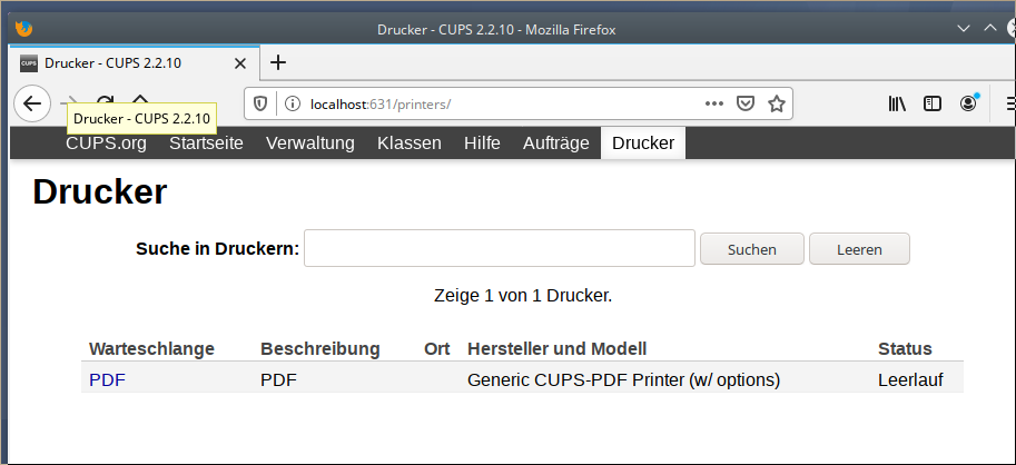

You don't need to add the PDF printer as it should be already installed, see the picture:
Do you see it in your CUPS interface ?
As you have virtual PDF printer installed, try to print anything from LibreOffice and post a result.

No, it is not to see it in my CUPS interface.

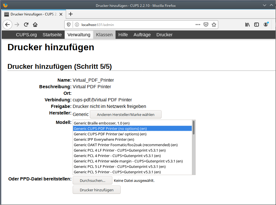

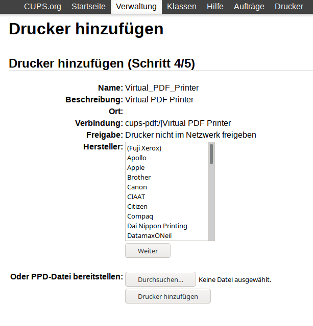

Another way would be to continue adding the printer as shown in this post https://www.q4os.org/forum/viewtopic.ph … 280#p17280 . You need to select "Generic" and  "Generic CUPS-PDF printer ..." in the "Hersteller" and "Modell" listboxes, see pictures:

Thanks for the tip with "Generic"
PDF printing under LibreOffice now works.
