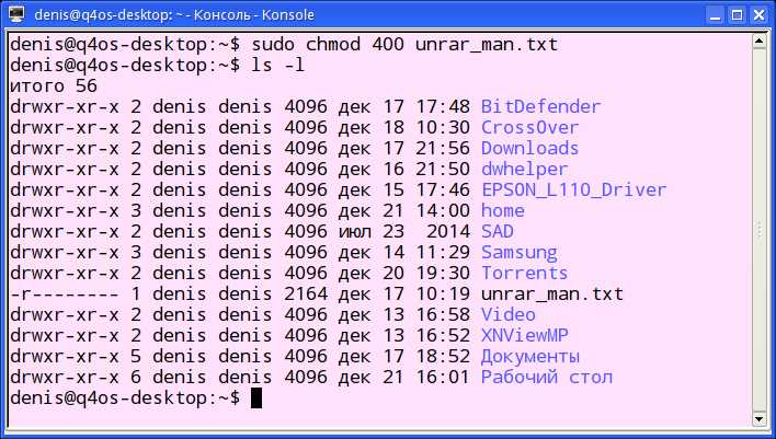

I have changed file permissions using command sudo chmod 400 unrar_man.txt
In Linux Mint after such manipulation I could not delete file or move it to recycle bin. I often used this to protect important files from accidental deletion.
I assume that permission Read should allow only to read contents of file but not write, modify, delete or change its contents another way. Does Konqueror behaves differently?

Yes, konqueror file manager behaves differently, it will remove such file the same way as 'rm' command. Write access is disabled. The default remove action is to move the file to trash bin.
