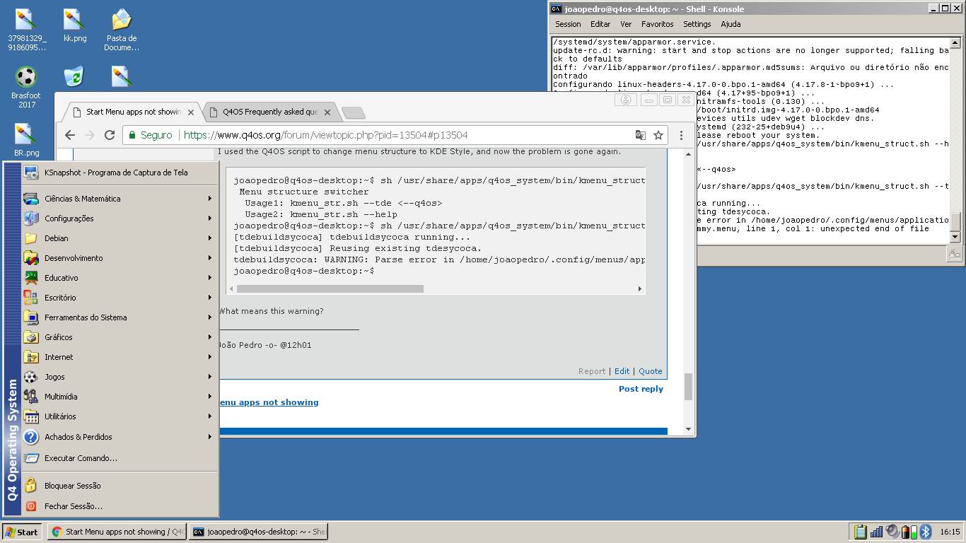

#12 2018-08-16 20:14
BrJPedro
From: BR
Registered: 2018-03-20
Posts: 75
Re: Start Menu apps not showing
You could also try to create a new testing user, login into his profile and check the menu items. You can fiddle with themes switching to find out, if the issue lies in the user profile or system wide configuration. Please post back a result, if proceeded.
Yes, I am in a new testing user account.
I used the Q4OS script to change menu structure to KDE Style, and now the problem is gone again.
joaopedro@q4os-desktop:~$ sh /usr/share/apps/q4os_system/bin/kmenu_struct.sh --help
 Menu structure switcher
  Usage1: kmenu_str.sh --tde <--q4os>
  Usage2: kmenu_str.sh --help
joaopedro@q4os-desktop:~$ sh /usr/share/apps/q4os_system/bin/kmenu_struct.sh --tde
[tdebuildsycoca] tdebuildsycoca running...
[tdebuildsycoca] Reusing existing tdesycoca.
tdebuildsycoca: WARNING: Parse error in /home/joaopedro/.config/menus/applications-merged/xdg-desktop-menu-dummy.menu, line 1, col 1: unexpected end of file
What means this warning?

#13 2018-08-16 20:19
Posts: 4,230
Does it mean, that the menu in the new user profile was wrong and after the script ran, it has been fixed ?
You can safely remove the '/home/joaopedro/.config/menus/applications-merged/xdg-desktop-menu-dummy.menu' file and run the script again.
