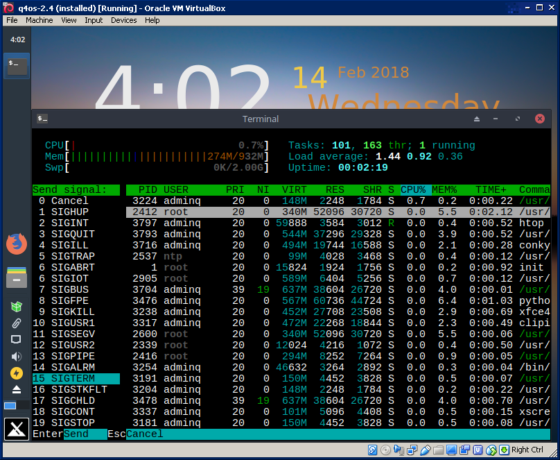

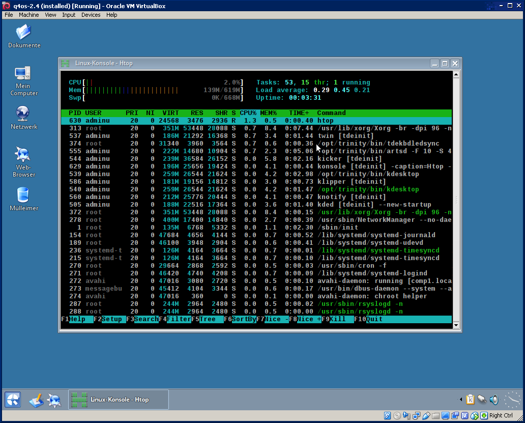

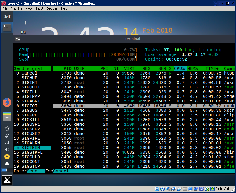

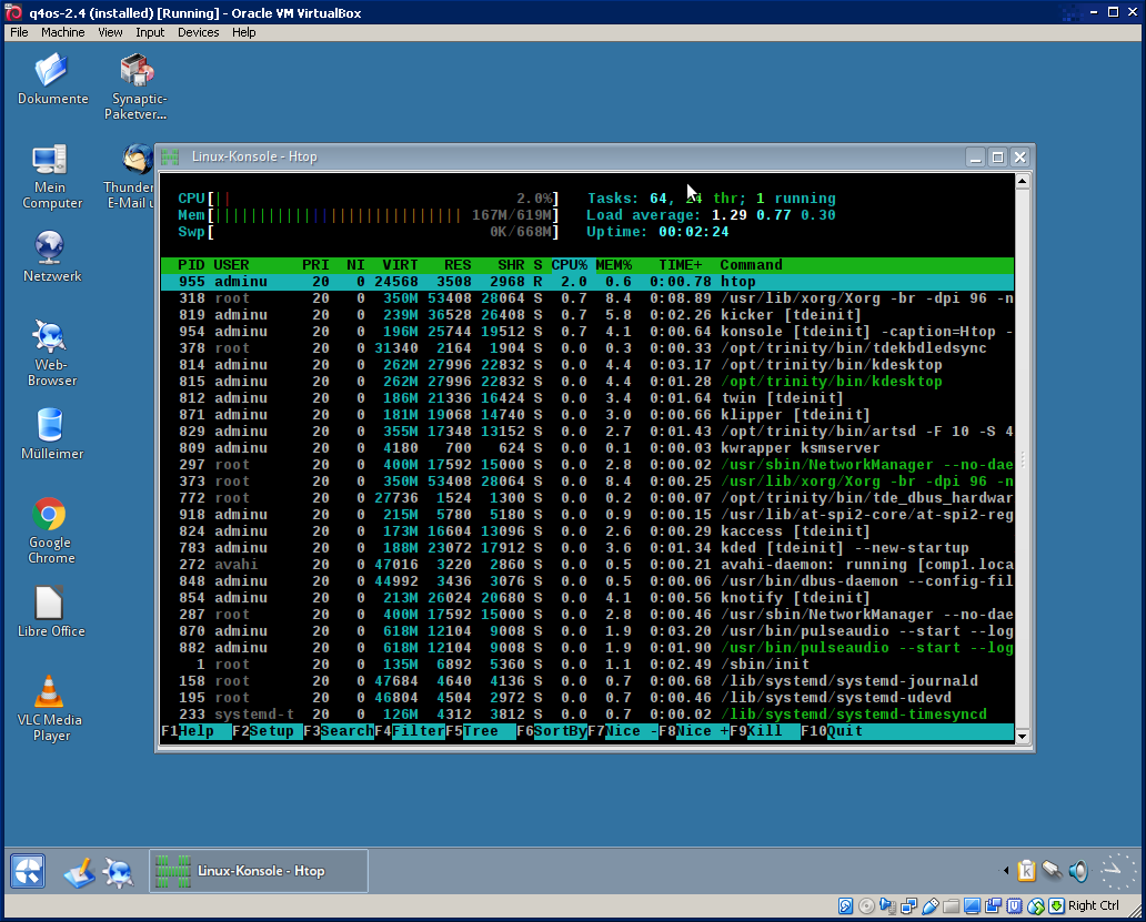

We have proceeded a very similar testing in Virtualbox for the 64bit Q4OS Scorpion stable, thanks Dai_trying for the valuable input. The only difference from Dai_trying's tests above is the total memory of VM, 640MB, and the welcome screen has been closed. These tests are easily reproducible for everyone.
64 bit system, q4os-2.4-x64.r5.iso, VM RAM 640MB
- 159MB - live-cd
- 136MB - installed with Pure profile
- 139MB - installed with Basic profile
- 167MB - installed with Full profile
It's notable, that the memory usage grows depending on the total amount of memory. It could partially explain some findings by crosscourt posted here https://www.q4os.org/forum/viewtopic.php?id=2086
Our testing of XFCE based Linux distros also show significantly higher memory usage comparing to TDE desktop. We had to increase the total memory to 960MB for MX Linux installed system, as it became swapping at 640MB.
