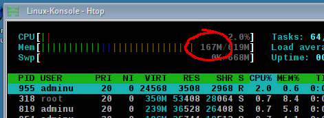

Htop in its default configuration clearly reports single numerical value of memory usage, see the picture below. This value represents direct memory usage and it doesn't include cache and buffers. We guess, it's the value quoted by crosscourt. Right crosscourt ?
