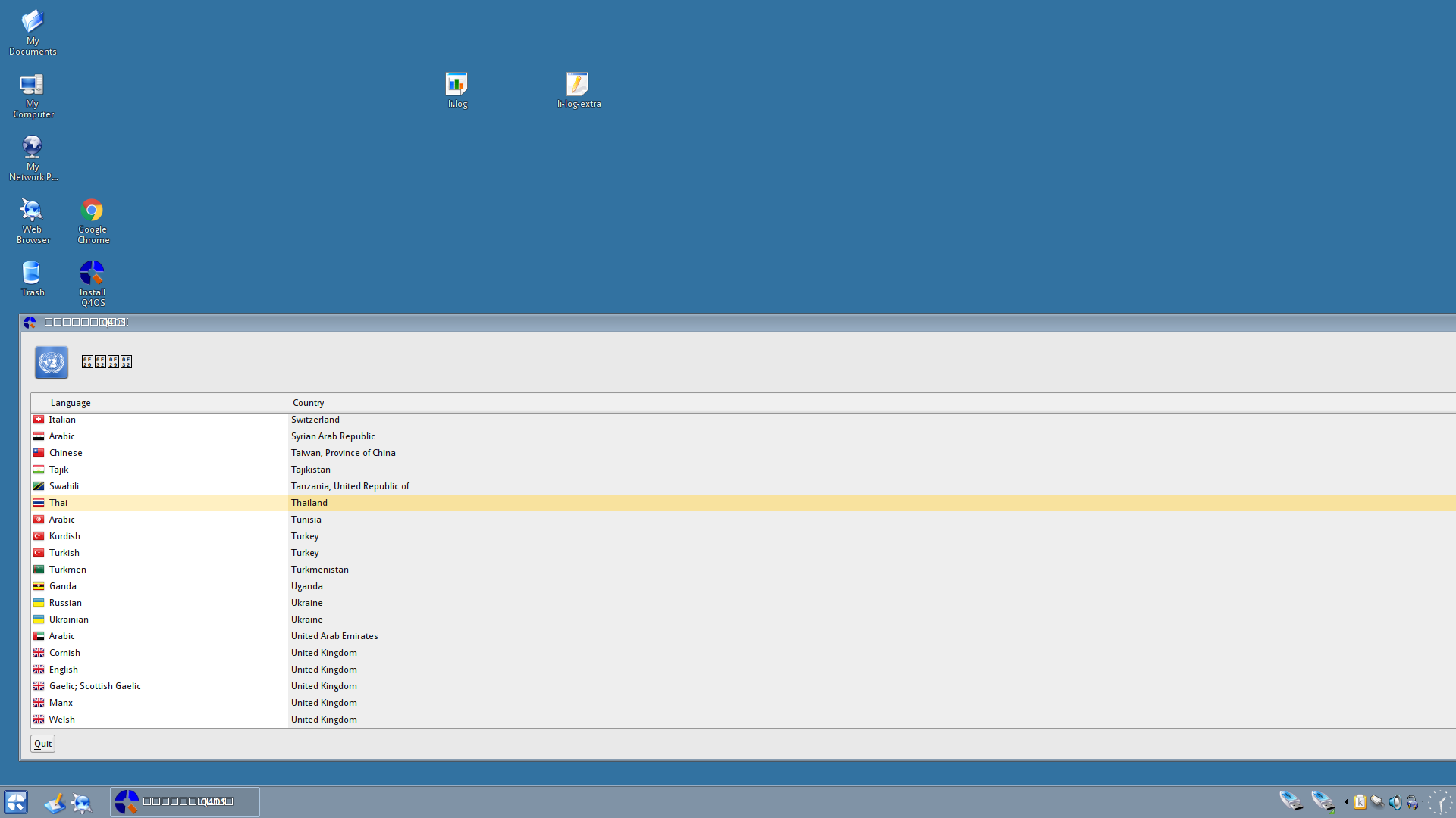

#35 2017-12-18 03:50
witloof
From: Thailand
Registered: 2017-11-15
Posts: 56
Re: installation screen
Very sorry for delay.
The following is done on my Desktop and the Monitor is :
Samsung SyncMaster S24B370  -  Screenwidth is 52 cm
Attached are 3 screenshots and 1 log file
li.log

#37 2017-12-18 09:59
Posts: 6,377
We are now able to reproduce the issue and can confirm a bug in live-installer. It's not hardware related and it's caused by incorrect translations for some languages. We have added a new bug into our bugtracker, it will be handled as soon as possible.
