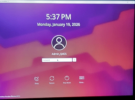

If I remember well, a live session doesn't show a login screen asking for a password. Can you post a screenshot of that login screen?

login screen see foto

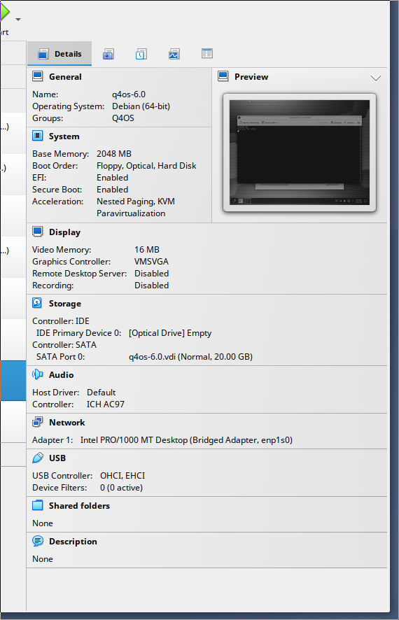

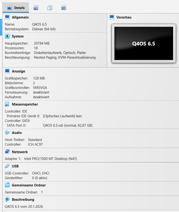

We have investigated, but we are still not able to reproduce the issue, Q4OS live boots fine. Would you please provide brief configuration of your Virtualbox machine something like the screenshot below.
shure...
here it comes...
