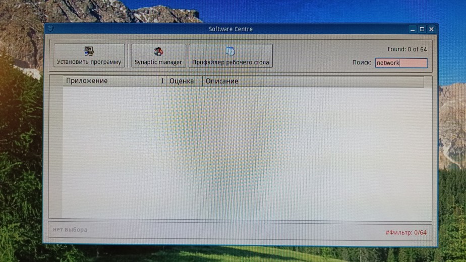

I have installed Q4OS 6.1 Andromeda Trinity on my old PC today.
When I tried to install Network Manager from Q4OS Software centre, I was unable to find it. Where it is? It is extremely important program for me. Without it, I am unable to configure my internet connection properly (DNS servers, IPv6), but my wireless network does not working at all without it.

The installer has been temporarily removed from the Q4OS-6 Software center. Applet doesn't start automatically due to a bug in Trinity desktop versions greater than 14.1.1 . We are working on a fix.
In anyway you can workaround the issue safely.
- Install from repositories:
$ sudo apt install network-manager-applet
- Reboot
- Run:
$ nm-applet
