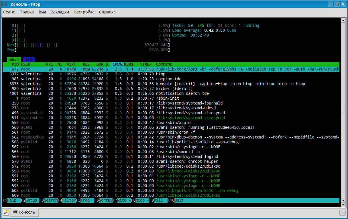

That is interesting. In my DELL Latitude E5450 I had completely the opposite situation. When Windows 10 was installed, the CPU was constantly loaded at 35-40% and the fan were spinning very often. After the Q4OS Aquarius TDE installation, The CPU stays at 6-7% even with opened Browser (Firefox) on Q4OS Forum, the fan is spinning very rarely, and the battery holds much longer. Note, that I have completely removed TDE PowerSave. No power saving functions are active.
Also, the memory consumption is much less, than it was on Windows 10. Now it is 500-1000 Mb. With Windows 10 it was 2000-3500 Mb.
