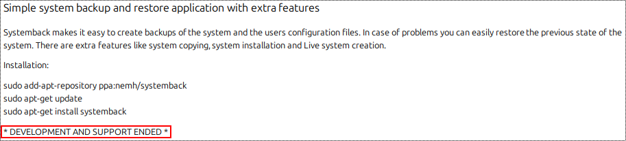

Michael_ wrote:
Also what about Systemback? Found that here on the forum.
Systemback`s development and support ended 7 years ago: https://launchpad.net/systemback
https://www.q4os.org/forum/attachment.php?item=873
So, I do not recommend to use it.
