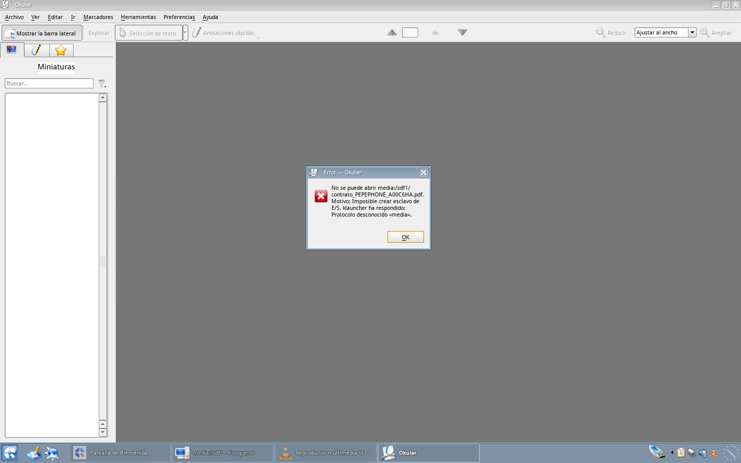

#14 2023-04-20 10:13
ivandebcn
Registered: 2023-04-14
Posts: 15
Re: I can't open files from usb memory
When i try to open files from usb stick:

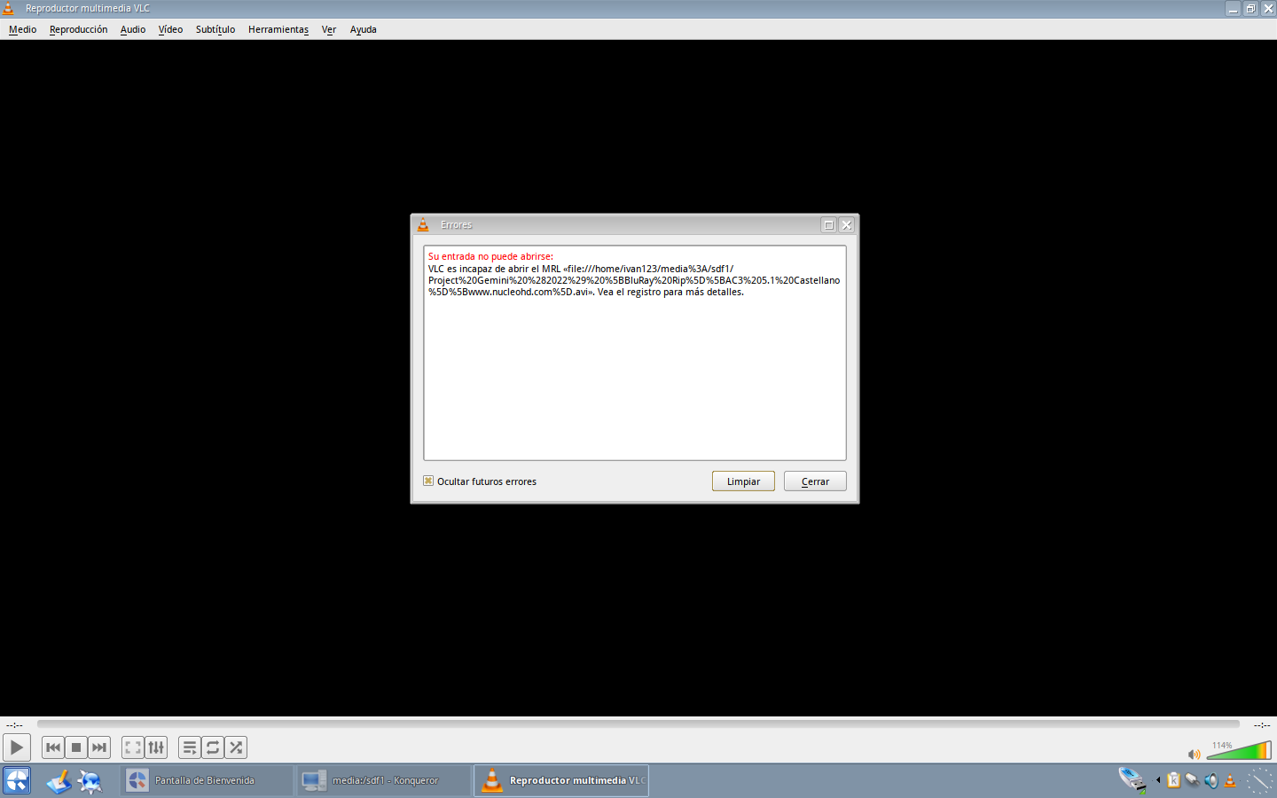

#15 2023-04-20 10:14
ivandebcn
Posts: 15
And this:
#16 2023-04-20 12:33
Posts: 5,027
It seems, you have encountered known Trinity bug https://www.q4os.org/forum/viewtopic.php?id=3826 as @bin mentioned above. It should be fixed in the new Trinity 14.1.0 version, what will be available in the upcoming Q4OS 5 Aquarius edition.
