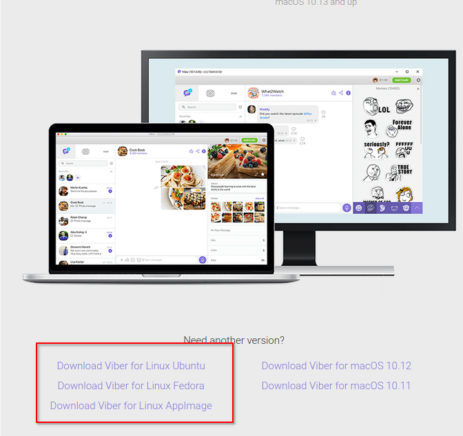

Viber has a native Linux installer as well as an appimage version, and both can be found here https://www.viber.com/en/download/ no need for Wine.
Choose the one for Ubuntu, it should install in Q4OS with no problems, or download the appimage.
