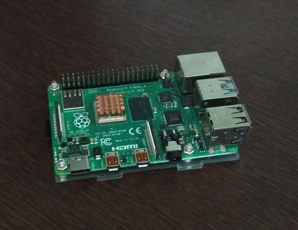

No boot and video on Raspberry Pi4
Good morning guys,
We got here at our Institute of Technology a beautiful example of the new Raspberry Pi 4, with fucking 4 GB of RAM! smile
But unfortunately we were unable to boot with the available version of Q4OS for Raspberry Pi (q4os-2.7-rpi.r5.zip). She doesn't give a video...
We tried with an LCD display connected directly to the GPIO bus and with a "mini HDMI/HDMI" cable on a 32-inch TV...
However, with the last Raspbian image it worked, we were able to boot and give video both on the LCD display and on the TV.
I even added a parameter that was at the end of the "config.txt" file of the Raspbian image in the same Q4OS file:
[pi4]
# Enable DRM VC4 V3D driver on top of the dispmanx display stack
dtoverlay = vc4-fkms-v3d
max_framebuffers = 2
But it also didn't work.

#2 2020-02-20 16:24
Posts: 6,114
Re: No boot and video on Raspberry Pi4
Did you try the latest Q4OS-3 testing image "q4os-3.10-rpi.r0-testing1.zip" based on Raspbian Buster ?
https://sourceforge.net/projects/q4os/files/testing/
https://www.q4os.org/forum/viewtopic.php?id=2990
It will become stable soon.
#3 2020-02-20 18:04
rafaelramos
From: Brazil
Registered: 2016-07-19
Posts: 146
Whoops!
I haven't tested this version yet. I will download it now and try it.
I will pass the feedback!
Thanks!
