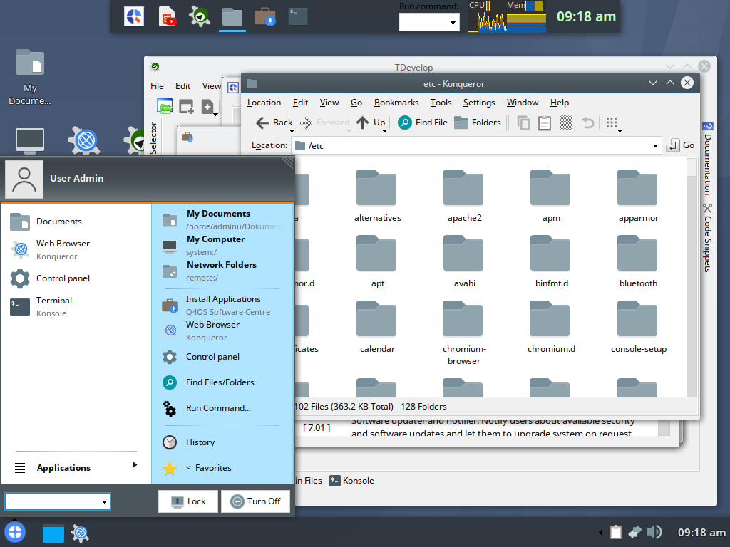

Greetings to the whole Q4OS community. I accidentally discovered this distro for raspberry pi on the web and I wanted to try it. At the moment grim is really good for performance and usability on my raspberry pi4 with 4 gigabytes of ram. I am testing it with programs for my music production hobby such as Ardor 6.5, Waveform Tracktion 11 and the latest version of Reaper 6.21 where they have added support for plug-ins in the lv2 format. Best Regards from Naples ( Italy)

Hi,this is my q4os system on raspberry pi 4 with 4 giga ram. It is very great system,very light and stable raspbian buster based. I stay testing this distro for my hobby music producer with ardour 6.5,waveform 11 tracktion,reaper 6.21 experimntal. All programs are native armhf v7 (raspberry pi version). Best regards from Naples ( Italy)  smile
