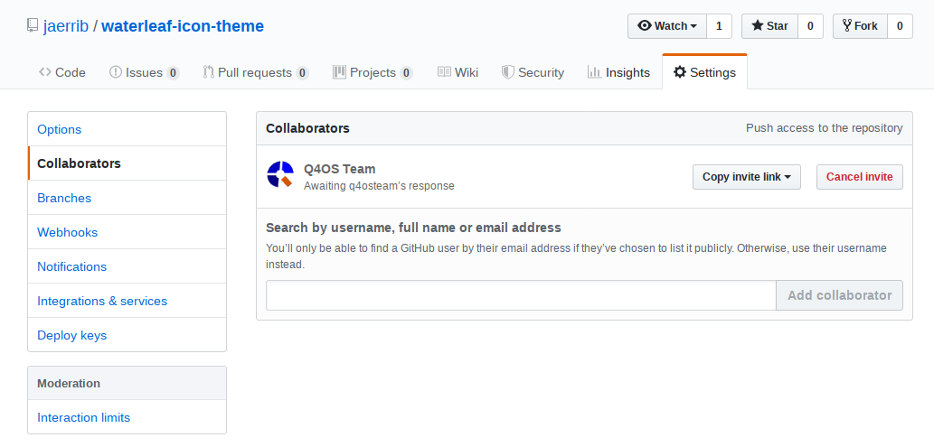

#4 2019-08-01 11:21
Posts: 6,483
Re: Waterleaf icon theme
It looks the access is still disabled, see attachment ?
#5 2019-08-01 23:50
Jaerrib
From: Pennsylvania, USA
Registered: 2018-11-18
Posts: 171
I'm new to adding collaborators on Github. The attached screenshot is what I see when I go into the settings. Am I missing something? Here's the invite link that should have come through: https://github.com/jaerrib/waterleaf-ic … nvitations
#6 2019-08-02 09:23
Posts: 6,483
We were able to accept invitation using the link provided. Thanks.
