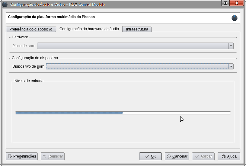

#8 2018-03-21 10:59
Re: Problem with Sound output
Your posted image would suggest you have installed some KDE packages rather than their TDE equivalents, I'm not sure how much of a difference it would make if you install the kmix-trinity package instead of just kmix...

I don't know why even in TDE, the sound with Pulseaudio installed isn't working. hmm
In TDE the Kmix even recognizes the hardware, but still no audio comes out. But now I noticed one thing: it was not to have, in that Kmix dropdown menu that is in the image, the alsamixer option?
I have not uninstalled it, and if I run alsamixer on the terminal it works. But was not he supposed to show up there, too? Is the problem in this?

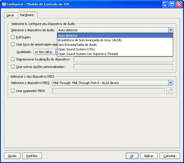

I think I found where the problem is. In TDE Control Center, these are the sound devices that are appearing to me to choose.
(In my opinion) it is as if the system was sending the audio through an audio device (ALSA or OSS), and Kmix controlling the volume level of another device (PulseAudio or HD Intel PCH). The two should be defined in the same option, right?
The problem is, how do I do it?
When I was with Pulseaudio and Pavucontrol-qt uninstalled, in Kmix there was only the "Default" option in the dropdown menu.
You need to keep the original value "Autodetect" here.
