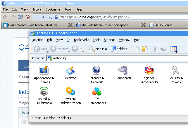

- The second thing concerns Palemoon as well: After having set up Q4OS the  first time (with kpersonalizer.tde2 &
  kcontrol.tde2) i did a screenshot  which i posted here:
http://fs5.directupload.net/images/170312/9g36nqwx.png
(the desktop is a matter of taste, but) please take a look at Firefox and it's Forward-button (in between the round
"Back" and the "Reload" button): It was one filled polygonal Arrow.
Now, after setting up q4os the recommended way (using the control panel apps) the Forward button in Firefox/Palmoon has changed, it now looks like
  /usr/share/icons/Adwaita/16x16/actions/go-next.png  (like "dot dot >").

BobbyBee wrote:
I don't think old browsers are worth keeping, because many websites no longer support it.
Accepted, but i do actually think they're worth it: They start up rapidly like a notpad, don't waste resources, an i know to use them blindly..
BobbyBee wrote:
You will most likely see html table content mixed up etc. I even experience this with Palemoon 24 (the last version supporting XP).
I disagree: q4os.org e.g.  shows up perfectly - even in FF 1.5!  And btw. there are many sites around that do show me a blank screen, even in newest Palemoon, urging me to permit them js, cross-site-scripting, tracking stuff and so on... In most cases i'll dont visit them further...
BobbyBee wrote:
Regarding the button, you can always try to install a theme, although it will be difficult to find one supporting Firefox 10.
Maybe i was not clear: the point is not at all the button itself - it has changed, and it's perhaps interesting to find out the cause why!

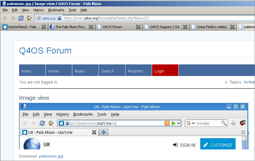

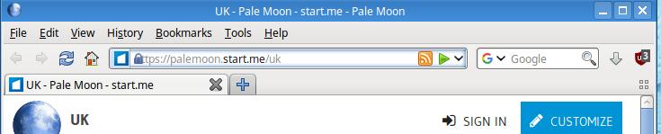

The GTK settings tool allows you to isolate GTK apps appearance from the influences of KDE which can help identify issues
Attached is my Palemoon - I use Plastik for Window Decorations and Styles and Clearlooks/Clearlooks-Phenix as described
You are using XPQ4

@Bin:
Second step in Control Centre>Appearance & Themes>Colours
Uncheck 'Apply colours to non-TDE applications.
I tried this as well, has no effect on the back/forward buttons of PM/FF. Attachment schows the difference in those two buttons perfectly, all otther buttons are identical. It's not grave, but i had exactly ,your' buttons earlier and still wonder about that change...

Bin, above you posted a scrennshot of ,your' Palemoon: https://www.q4os.org/forum/attachment.php?item=213
It shows the ,original' back/forth buttons, BUT: besides the reload and home buttons, which are the same as in my PM/FF!
So my question now is: where are those( GTK2-) icons stored in Q4OS? And how can i view (and eventually change) them.
In my case there seem to be missing something: Gathering more information abot Trinity, i found that page here:
http://netrunner-mag.com/2014/01/25/the … t-trinity/
and it shows a "Trinity Control Center":
http://netrunner-mag.com/wp-content/upl … themes.png
that has much more entries under 'Appearance & Themes" than mine (-> attachment).
Particularly there are missing "GTK Styles & Fonts", "Icons" and "Styles"...

sudo kcmodules --unlock
copy /opt/trinity/bin/kcontrol.tde2 to your desktop and rename to Control Centre - this is what I use and was the default in the old days.
As to the Palemoon icons - I can only guess that they are hardwired into the Palemoon Default theme in some way and reference possible sets in /usr/share/icons or ~/.icons or possibly even stuff they may find in other local Moz based apps.
This looks like a good starting point - I am sorry but once we start getting to userChrome.css my mind goes blank!
