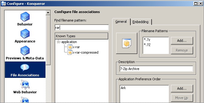

No, the rar-archive is not password protected.
Maybe there is missing a File Association configuration in Konq. Here the Application preference is set to Ark rather than to Unrar (see the attached snapshot).
One additional question: (Where) can i find an icon-set, that provides different icons for the different types of archives (Zip, TAR, Rar, 7z)?
Thank you!

Ark(-trinity) handles the rar archive without issue on my system, one thing to check though is whether the file is actually a rar archive, I had an issue where a file had the rar extension but was not actually a rar archive,
file /path/to/archive_name.rar
should give you the file type, something like "RAR archive data" should be found. If it is a correct rar file then I can only think that it uses a compression routine not currently known to your version of unrar.  Scorpion verion = 1:5.3.2-1, Orion version = 1:5.2.7-0. Although I don't know without searching what the differences are between the two versions.
You can use any icon you want for each archive type by simply clicking on the icon in the screenshot you posted and it will open an "icon selection dialog" you can choose your preferred icon to use, and if you cant see one you want a google search on "archive icon" will give you many results to choose from.
