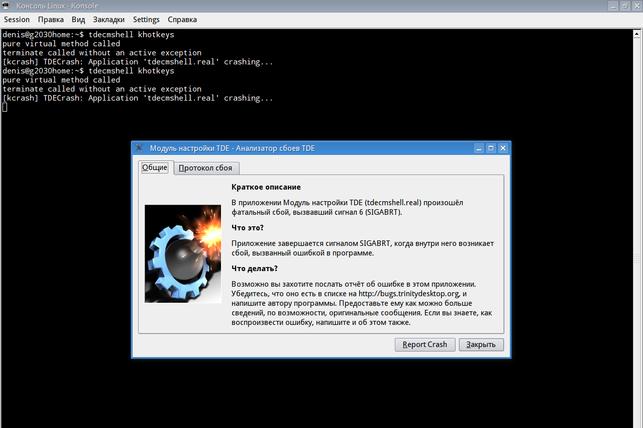

#5 2017-09-12 12:26
Posts: 681
Re: Error, when I try to delete an action
Crashed, without saying almost nothing...

@Dai_trying
We are not able to reproduce too, thanks for the report.
@Rademes
As it's not easily reproducible, we guess it's a TDE related glitch depending on a specific khotkeys configuration. You could edit the '$HOME/.trinity/share/config/khotkeysrc' config file and remove manually all references to this particular action.
