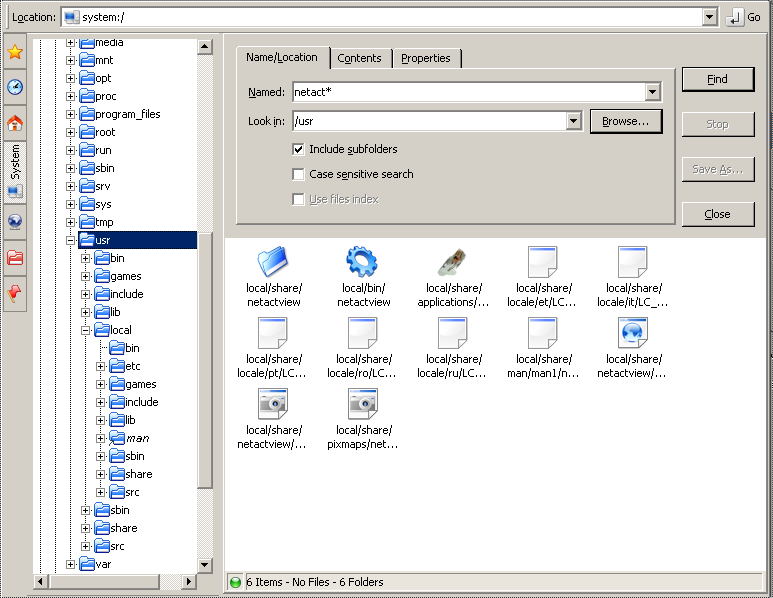

Well, finally i did get it up running wink i had to install all the dev-libraries, all of them now make up nearly 1 GB on the disk!
It is not as feature-rich as it's Windows equivalent TCP-View (of  Mark Rusinovich i think, NetActView lacks e.g. the ability to terminate connections or even end processes) but it's a nice tool anyway, and a must have imo!
(Some people might be flabbergasted when realising what happens to their system while browsing the web, especially with google's chrome!)
I did the compile/make orgy on my second HardDisk, and now i wonder how to get it running also on my main system too.
So i did a search for  netact*  under the /usr folder, and it shows up about 6 files (the locale-stuff shouldn't be that important for the moment) see the 2nd snapshot.
How can this be made kind of ,installable' for other q4os-users to use?

#19 2017-05-02 20:33
Re: Installing "Network Activity Viewer" -> no acceptable C compiler
If you have built this from sources then you should have a bunch of .deb files that could be used to install onto another machine but you might need to install some dependencies in order to have them work. Some of the time you might get away with using apt-get -f install after installing your .deb file (using dpkg), it might not work but if you test in a VM it will be easier.
I also found a lot of other net-tools and you might find something that suits your needs without having all the hassle of building from sources, two links provided that might help...
