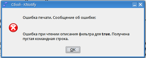

I also can not print from KWrite and Kate. Just get an error message:
I can print from Chromium, OpenOffice, Okular, so I am sure, printer is installed correctly.

#8 2017-01-15 01:34
Re: Kate and Kwrite Print Error
I just tested my installation and both kwrite and kate are printing ok. I can't translate your error message but if you paste it as clear text i can run it through google translate and maybe help with it.

#10 2017-01-15 09:06
Posts: 6,483
@Rademes
We are not able to reproduce it too. Any additional information would be appreciated.
