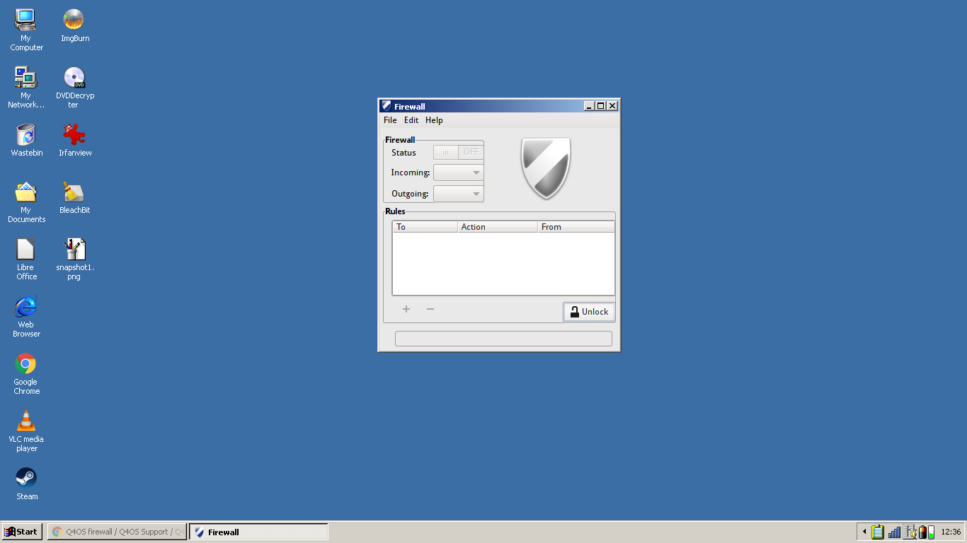

Actually I reinstalled, but couldn't replicate the error, as programs is showing correctly now. So maybe it was something I did :-) Does the gufw application start automatically at boot, because when you type sudo gufw it comes up greyed out until you click unlock and then it shows correctly?
We are going to check it and make a post here as soon as we have some result.

I did the sudo ufw status thing and it does show the firewall running despite it being greyed out when I type sudo gufw. It also shows it is set to start on boot. So that's good, it just the gufw part doesn't seem to be on when you first boot up.
Anyway thank you for your help, at least I know the firewall is working :-)

One more trick for you. In the terminal, istead of "sudo" type "gksu gufw", then press enter. The gui will pop-up, THEN click the "unlock" button...
