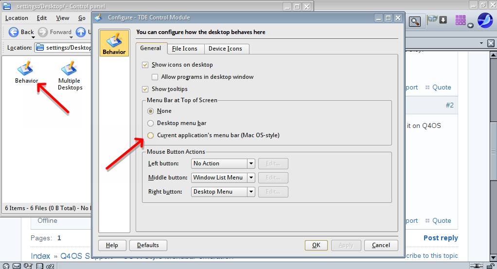

You can get something like this effect by going into the Control Panel and selecting Desktop -> Behaviour then selecting the "Current Application's Menu Bar" option.
Although, I think the menu bar that appears only works for TDE-centric apps, but I'm not sure on that.
