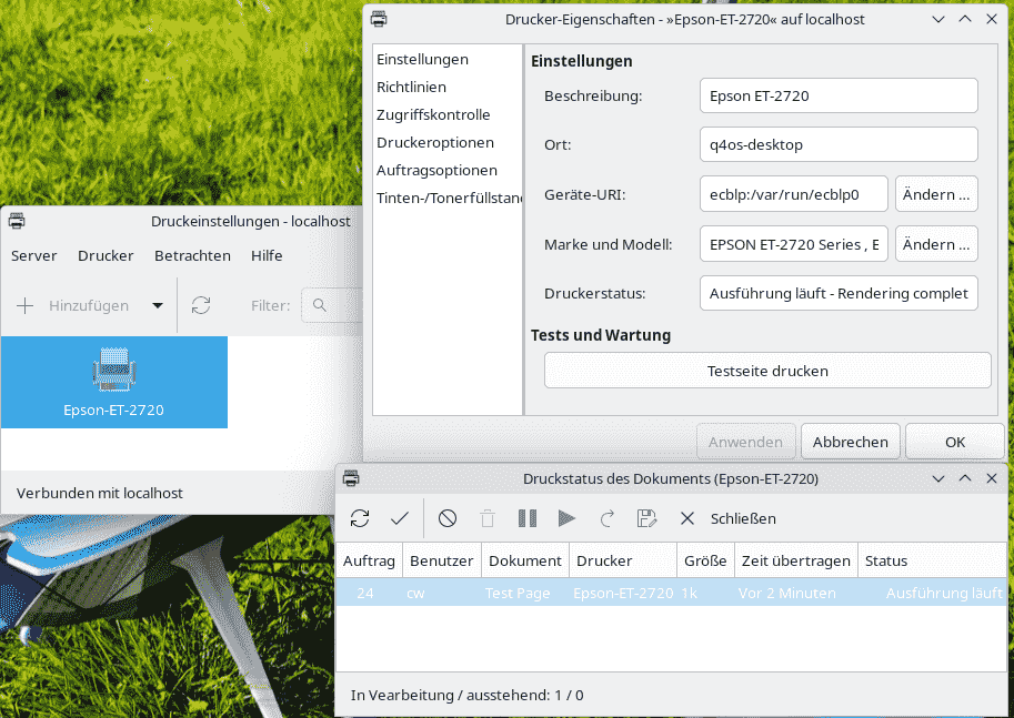

I lauched the printer setup from the Q4os system menue and set up the printer.
Oh man... easy going... i thought... but when printing the testpage nothing happened.
The testpage stuck in the spooler saying "printing" but nothing arrived at my physical printer.
What can i do to get my physical printer working?

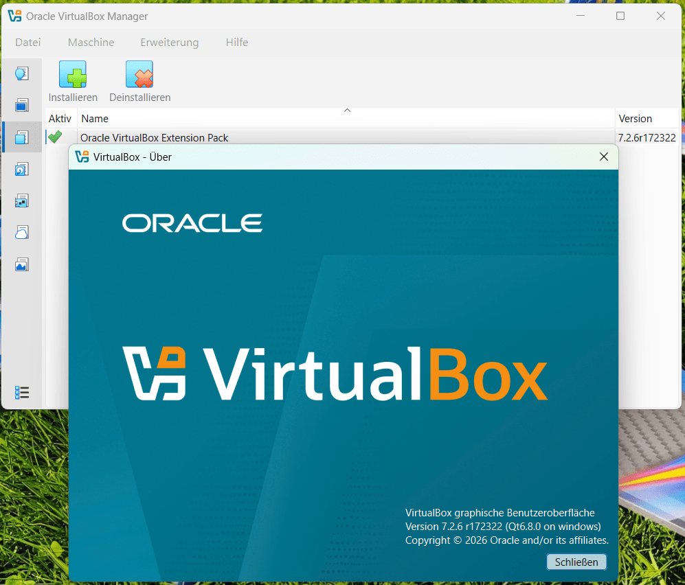

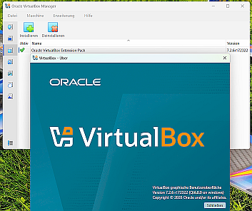

ok... i made an Attatchment to post #4. Is something wrong with this?
That looks fine, the same version.

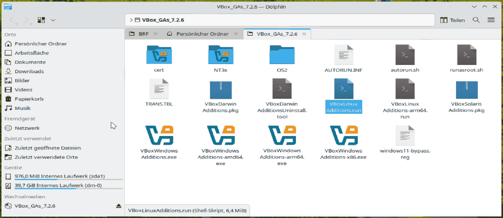

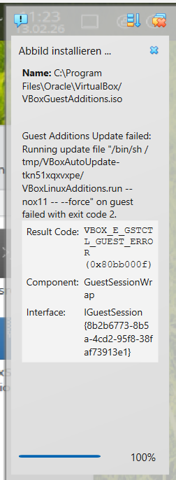

I would like to update the installed Linux guest Addition to make it permanent but i failed doing this...
Copy VBoxLinuxAddtions.run to your Downloads folder on the VM. You can then eject the iso image.
Open Konsole (Terminal)
enter
sudo apt remove virtualbox-guest-*When that is finished reboot the VM
Once that is back up open the Downloads folder, right click on a blank area and Open Terminal here.
enter
sudo apt install gcc perl makeThen
sudo ./VBoxLinuxAdditions.runThat should complete without errors.
Reboot the VM and all should be well.
