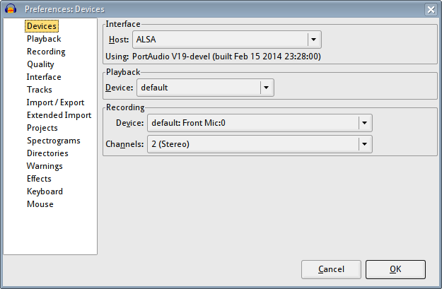

A bit late to the party with this, but I just checked audacity preferences and you can select the input there... screenshot attached Can't imagine you didn't look there, but I overlooked the obvious and thought maybe you did too.

Yes Dai
Had no effect....still couldn't record with it on my 2004 machine......ugh..!

Out of curiosity did you have any options at all in the recording devices?

Re: Audio Tape Converter
No options at all.....Dai ....ugh...!

Then you do not have any (working) audio input available... Almost definitely a hardware issue, but you could try the Scorpion(2.0.2) live-cd and see if the newer kernel might help, but as it is a relatively old system, it might not be any better...
