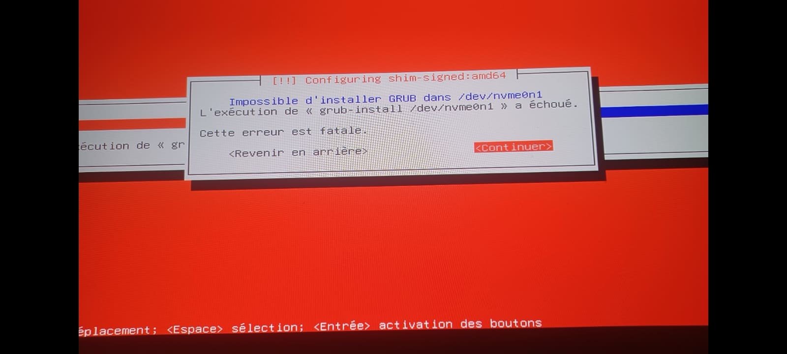

How can i send a screenshot cause i did what you said to do about downloading the install CD and I've got a FATAL ERROR with big red colours on the screen and somehow it glitch and my password I've create and checked twice to see if its correct doesn't work what can i do because for now I can't do anything with the pc

Thanks for the help for adding a screenshot and its is the fatal error its in french but it said that there's a BIG problem about the grub and somehow the password doesn't work and the username do even since its the same I'll be grateful for the help

frenchdivision wrote:
... i'm always forced to go into the grub and doing this command for loggin :
set root=(hd0,gpt2)
linux /vmlinuz root=/dev/nvme0n1p2 ro
initrd /initrd.img
boot
Are you able to boot Q4OS this way ? If so, run in terminal:
$ sudo grub-install
$ sudo update-grub
and post back what happens.
