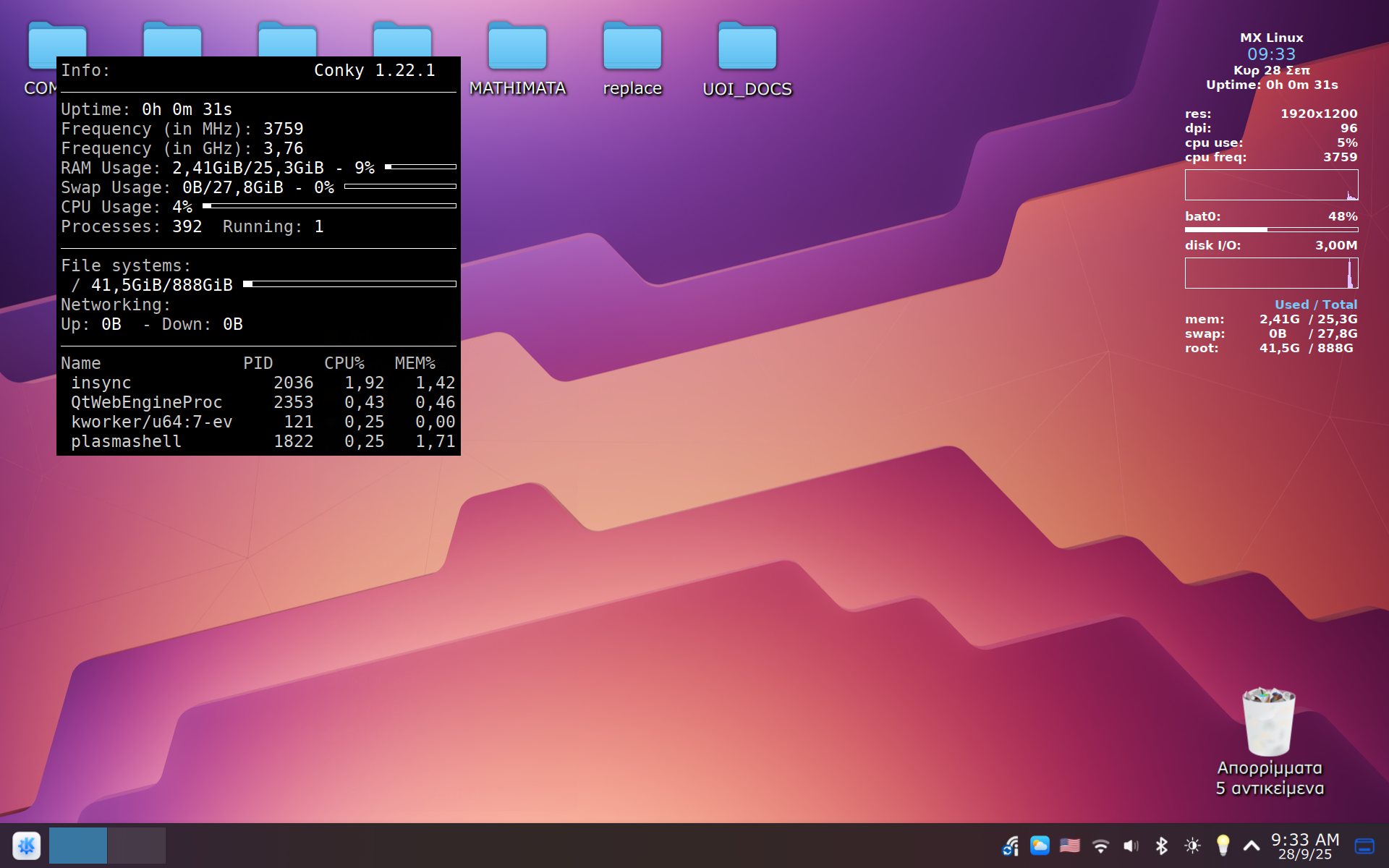

I can not use any conky theme in Q4os Linux. Every time I add a theme two conky windows appeared on the screen.
One one the left with information on black and one on the right with the selected theme.
Any help?

And here is a link to the screen
http://itsoulos.teiep.gr/conky.png

I have installed conky-manager2 from here https://launchpad.net/~ubuntuhandbook1/ … _amd64.deb  and I have downloaded some themes from MX. Subsequently, I opened the conky manager and I select one theme. When the system reboots two themes appeared on the screen as the screenshot in the related URL that I have sent you

How can I do that? I have followed every method that I have found in the internet and always two conky windows appear on my screen.
Is there a proper way from debian to start a custom conky theme automatically when I login to kde?

I have done this. How can I add themes ? The only theme is a black window that appears on the left

The only solution found so far is to copy the Conky Resource file to ~/.conkyrc  and reboot
