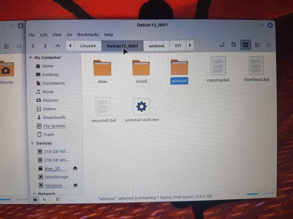

Ok. Then I have a lot of "grub" and others files in :
- /mnt/host/Linux64/Debian12_S001/winboot/EFI where /mnt/host/ is my Windows disk.
- No file in /mnt/host/Linux64/Debian12_S001/install/boot/grub/
Noe of those folders / files have been modified yesterday at that very moment when I took wrong actions.....

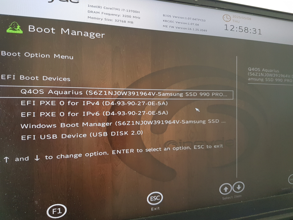

---- AFTER REBOOT ----
BIOS seems OK. EFI enabled as secured boot too.
First option is Q4OS Aquarius as seen on the picture.

The \EFI\Microsoft\Boot\bootmgfw.efi is - I thought - what appeared to be missing in the C://Windows/Linux64/DebianS0012/.... But I am probably wrong.
I am attaching two pictures of my tree structure of the C:/Windows/Linux64 folder.
I am seeing bat files that could perhaps be of help? Like fixefiboot.bat ? Has someone some XP with those ? Shaall I dig into what they do ?
4) Do you think I should try to boot the computer I use with Boot-Repair Live USB WITH THE SSD ?
Thank you again for the help you are providing guys and girls.

Image I cannot add in the previous POST.
#16 2025-05-10 13:46
Posts: 5,828
Re: Grub not starting at boot after maintenance- cannot launch OS
You can edit a post to add multiple attachments.

Sorry smthg went wrong ; 2nd image was rejected. Trying again.
DOESN'T WORK - error = Max limit exeeced although file is 309Ko
2nd image shows :
C:/Windows/linux64/Debian12_S001/winboot/EFI/disks (d)
C:/Windows/linux64/Debian12_S001/winboot/EFI/install (d)
C:/Windows/linux64/Debian12_S001/winboot/EFI/winboot (d)
C:/Windows/linux64/Debian12_S001/winboot/EFI/copylog.bat
C:/Windows/linux64/Debian12_S001/winboot/EFI/fixefiboot.bat
C:/Windows/linux64/Debian12_S001/winboot/EFI/mountefi.bat
C:/Windows/linux64/Debian12_S001/winboot/EFI/uninstall-wubi.exe
