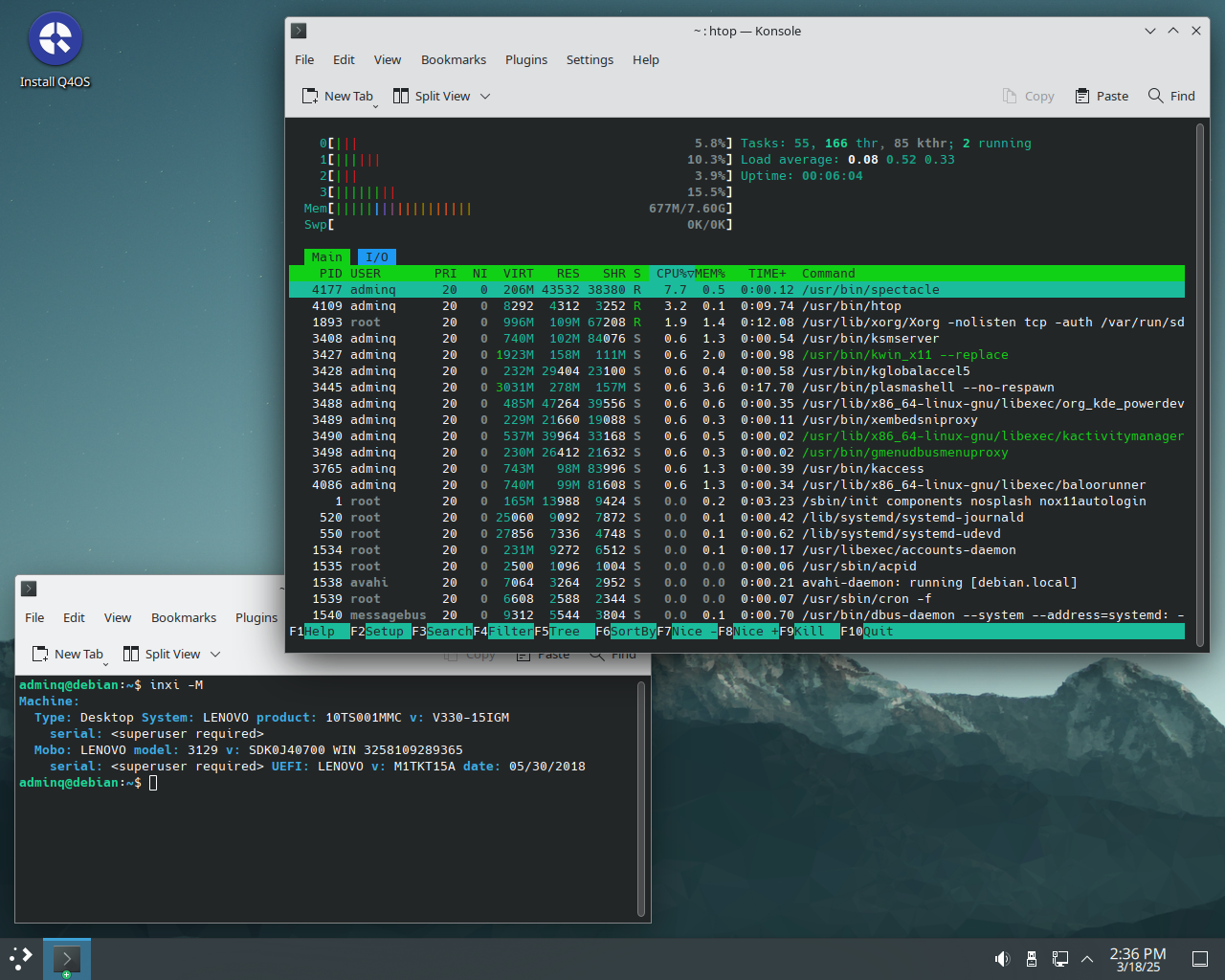

The next test is framed as a copy of the original post https://www.q4os.org/forum/viewtopic.php?id=5260 , but this time on real hardware instead of virtual machine.
Htop shows memory usage 677MB, almost the same for both, hardware and VM. However we have closed welcome screen and run another konsole with the inxi command instead, so the memory usage might be by a few MB higher.
Procedure:
- Lenovo Desktop PC 10TS001MMC
- memory 8192 MB
- boot the most recent Plasma Live media, Q4OS 5.7
- close welcome screen and run konsole with inxi -M command to identify the hardware
- let the OS settle down for a four minutes
- run htop to get memory usage
Results (Memory usage by htop):
Q4OS .. 677 MB (ver. 5.7)
