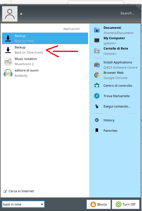

I have two questions for you now: first, I noticed that there are two options on the Trinity menu for launching Back In Time, one as regular user and one as root:
backintime
Do you know if is it possible to run it as root and back up the whole PC, maybe excluding the /home folder and backing that up as regular user, if backing it up as root is found to cause issues? I'd like to ditch Timeshift if possible, as it only caused me headaches up until now (maybe I'm wrongdoing something, if someone helps me out on that I'll gladly reconsider my judice).

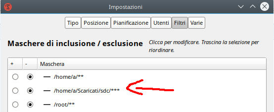

Second, do you (or someone else) maybe know why Timeshift doesn't give a damn about filters / exclusions? I set it up exactly like I did with Back In Time, telling him not to rsync the /home/a/Scaricati/sdc folder and it acted like the exclusion wasn't there at all (I marked with the red arrow the exclusion I made):
timeshift
Thanks again anyways for suggesting Back In Time, I just set up a backup job of the home folder and did the first run.

BIT (root) allows you to back up files to which your user account does not have access. For this you need root access. It's just a backup tool - I don't think I would want to try to do a system restore with it. Actually I never bother that stuff. If I break it I just re-install as by then it's probably a mess anyway..... smile
