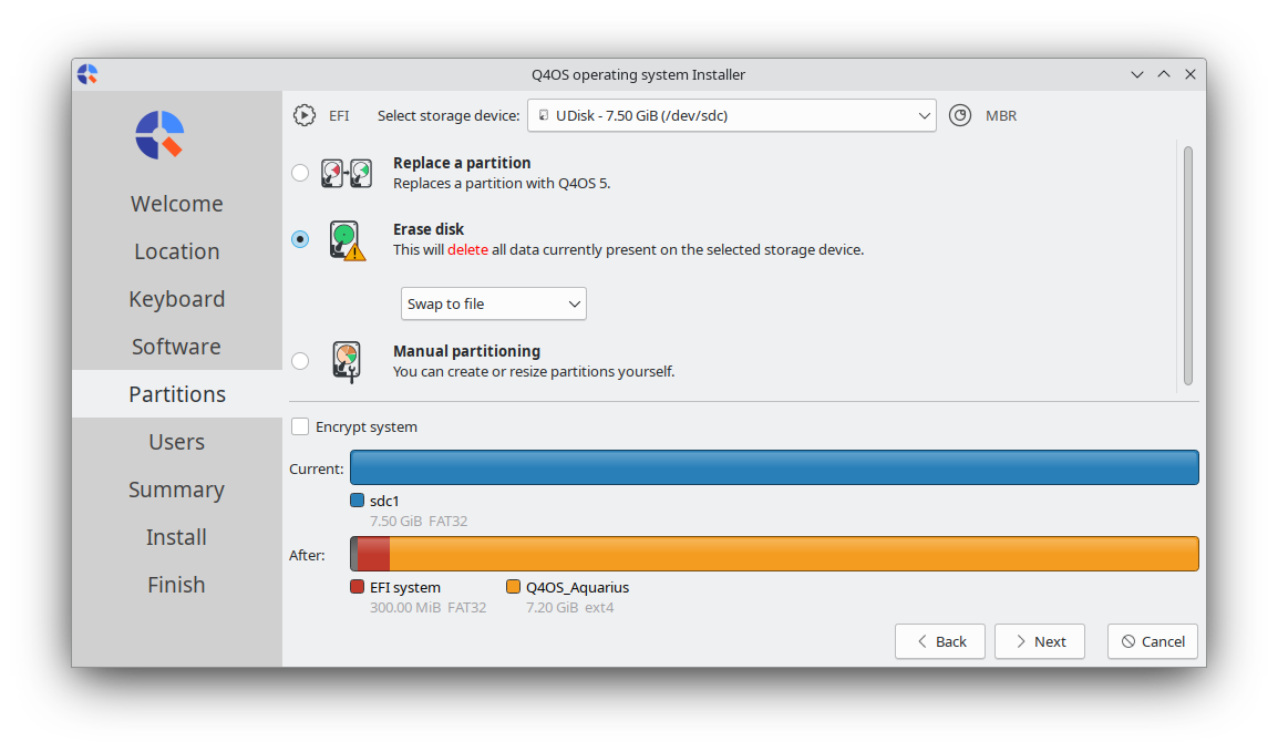

We cannot confirm the issue you reported so far. We have made testing install on HP laptop from live media q4os-5.4-x64.r2.iso to a target USB stick. The installation went fine, all partition has been created as expected and Q4OS is booting well.
Installer created EFI system partition on the USB stick and didn't touch the internal hard disk. A UEFI record has been inserted in computer EFI firmware, so all good. System is booting fine after multiple reboots.
Live installer automatic partitioning:
We would ask you to provide detailed steps to reproduce the OP issue for us to be able to reproduce and investigate.
