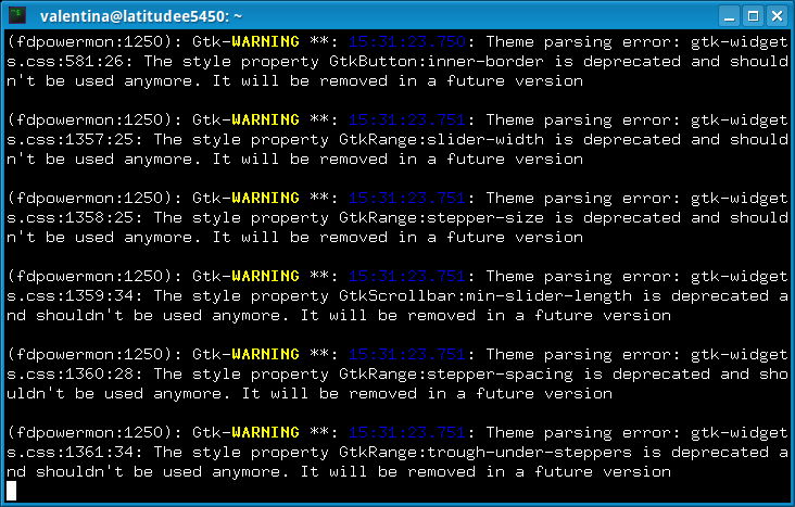

@vanquishedangel, which Q4OS version do you have? I have installed fdpowermon on my Q4OS 5.2.1-n1 Aquarius with Trinity R14.1.1, and on my laptop fdpowermon does not starts at all. I always get an error in attachment.

I have run it on both Gemini 64 bit and Aquarious 5.2 64 bit. It looks like the widget is not compatible with the theme you are using. I am uding TDE that came with aquarius. I installed Q4os Pure. Q4os-desktop-trinity

The theme that I use is debonaire. I then changed it to look how I wanted. Looking more into this it appears that it is a conflict with the theme you have installed and are using (or the theme program). Not all applications are compatible. It seems like you installed an updated version if TDE or are using a Beta or testing version. This means it may not be compatible as they (or just fdpowermon) are not updated to work together yet in the repositories. These errors also happen when software (themes maybe) for one OS (ubuntu lets say) is installed on a different but close OS (q4os maybe). Certain things will not be compatible in that case.

I have written to fdpowermon`s developer, and he replayed, that fdpowermon does not starting because my battery is 100% full. That is because the developer does not likes the battery icon to be shown when the battery is full: https://github.com/yoe/fdpowermon/issues/6
Here is written, how to change that behaviour: https://bugs.debian.org/cgi-bin/bugrepo … bug=823732
This is by design. Personally, I don't want to see a battery icon when
the battery is completely full. Following my philosophy of "fdpowermon
ships with the configuration that I prefer", that means you won't see it
either unless you change the configuration.
If you do want to see the icon when the battery is full, you need to
edit /etc/fdpowermon/theme.cfg (or copy that to
~/.config/fdpowermon/theme.cfg and edit it there), and change the bit
that says "99:battery-charging.png" in the "charging" line to say
"100:battery-charging.png" instead.
Anyway, Thank You very much for finding an alternative to TDEPowersave. I hope the Q4OS Team will fix it soon... Currently, TDEPowersave is unusable.
